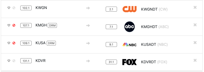

So I bought an ATSC 3.0-capable HD Homerun today, and hooked it up. I knew DRM was not a solved issue, but I thought I could get some use out of it for the single ATSC 3.0 signal I can see. What I see in Channels:
  • the DRM-protected signals for ABC and NBC on RF 34 in Denver are banned (good choice)
  • the guide shows no program info on CW 102.1 and Fox 131.1 (this seems dumb)
  • the web viewer has picture but no sound for the ATSC 3.0 channels

The worst part is no info in the guide for these channels. This seems stupid, as the data
is present, it just needs e.g. 2.1 data copied to 102.1. Can someone explain this one? If
this worked, I could create recordings from a better signal, even if I had to find a player with
AC-4 support.
If I am missing something, yell.

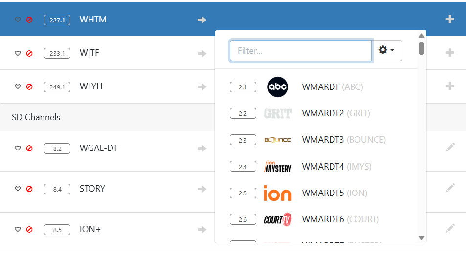

For guide info, you can map the 1.0 channel guide to the 3.0 channel. GO into sources, click the channels under the tuner (in my case, 42 channels):
Then click on the plus on the channel you want to map the guide to:
Then select the channel guide you want to import and it will now map the 1.0 channel to the 3.0 station.
On the audio front, Channels works for me with the 3.0 Channel audio, but some other players do not. Couldn't tell you why, others will know better than I.

Thanks Jator - I have this:
It looks like Channels has figured out the correct mapping, so now I do have guide data for 102.1/131.1.

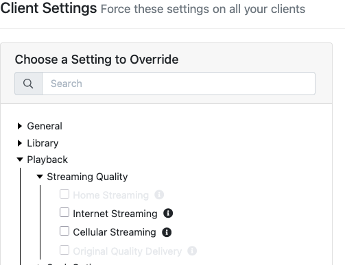

I tried to fiddle with settings in Settings -> Clients -> Client Settings -> Playback -> Streaming Quality. I hit "Original Quality Delivery" and it's now gray and can't be further changed. I then hit "Home Streaming", and it's also gray:
clients
I am just using the web interface to try to view things, not a downloaded client right now. Were you tweaking on a downloaded client?
The web ui always transcodes, it’s possible your server just can’t transcode ac4. Try to play the channel on a real client using original quality.
Audio will play back if you use the official Channels app
The web interface is not indicative of client
Yes, AppleTV in my case:
Indeed, my only real client, the Channels app on my Fire TV Stick, plays audio. So I assume we're waiting for ffmpeg to decode AC-4 for the web ui use case.
My server transcodes ac4 just fine in the web ui but not all servers are created equal. A recent intel or amd should handle it. My guess is you’re probably using a NAS or something older.
I have a Dell, not especially new, with up-to-date Windows 11 and a good Nvidia graphics card. I don't have reason to think it's not able to handle it.
