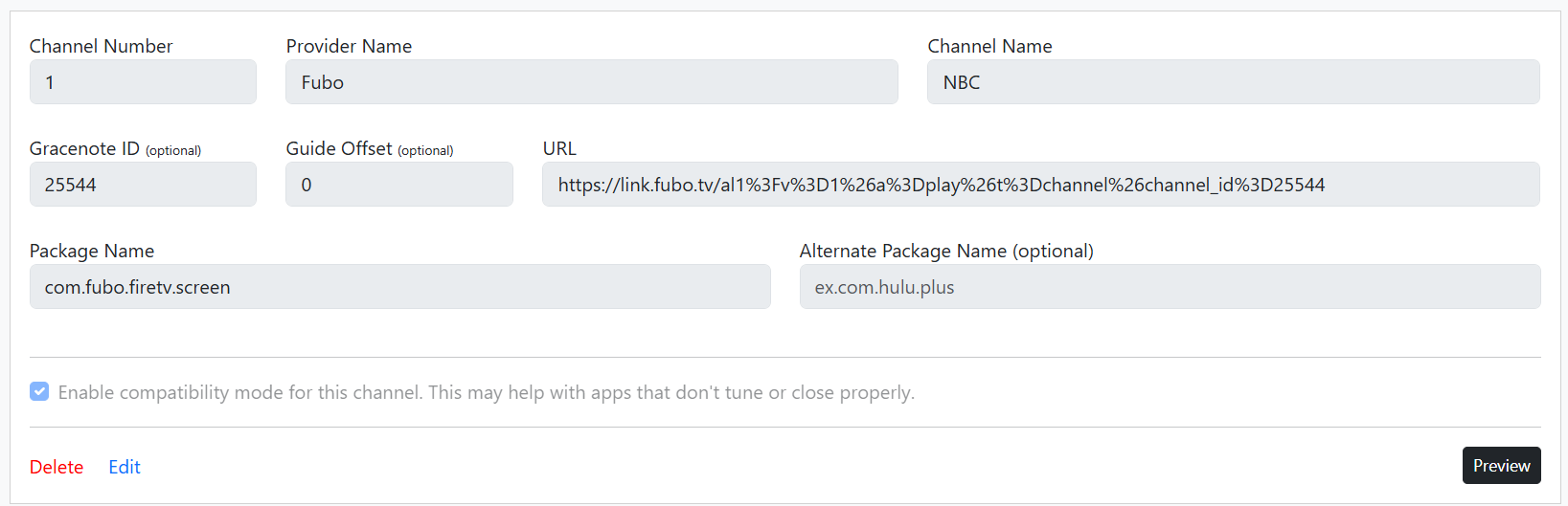

I'm using the Fubo app with ADB Tuner with my ONN 4k. The app is a little slow.
here is what i use for METV.
https://link.fubo.tv/al1?v=1&a=play&t=channel&channel_id=122696
Use compatibility mode and pick the FUBO App option.
I would suggest watching the feed on the hdmi encoder so you can see what is happening.
Oh! There’s a FUBO option? Or do you mean selecting it as the package name? I’ve done the latter, but am unaware of the former.
Watching via the tuner shows that it does eventually load the channel, but it’s well after the timeout for Channels.
You want to select the package in ADB Tuner.

My wife is team NBC (Today, NBC Nightly News, Daytime Talk shows). For some reason, NBC will about 1 in 3 to 1 in 5 times when launching just come up with the NBC home page on Fubo (see below screen shot). I thought it was just 1 of the tuners, so I enabled the tuner priority in ADB and put that one last, but have since seen this same dynamic with Tuners 1-3 as well.
Here's what I see when it doesn't tune in the "live" version:
Backing out and relaunching usually solves the problem which is fine for live tv watching, but for recording purposes that doesn't work.
I don't see any errors in the logs, anyone have any suggestions on how to fix?
Also, I do have OTA access, but have periodic "hiccups" in the tuner just on NBC, not other networks. Signal strength is great, I've even introduced a spitter to see if the signal was too strong (use a Televes with built in pre-amp and 5G filter), but still see the hiccups.
Here's the NBC entry in ADB as well.
Thanks for any assistance.
Jay

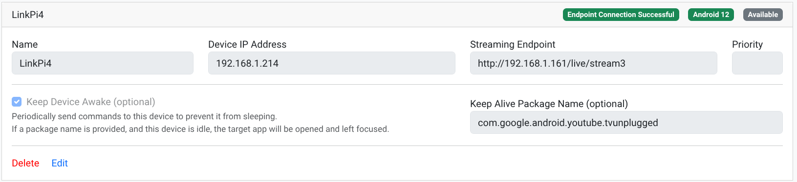

I have been wondering if it is possible that the "Keep Device Awake" option in ADBTuner may occasionally cause my OliveTin ADBTuner Device Alerter to show a device as disconnected. Or, perhaps something else may be causing this error.
This happens once every few days, each time to a different device.
{"name": "LinkPi4",
"device_ip_address": "192.168.1.214",
"device_connected": false,
"streaming_endpoint": "http://192.168.1.161/live/stream3",
"streaming_endpoint_connected": true},
Every time it happens, I check the ADBTuner GUI and it shows all tuners Connected and available:
As you probably know, OliveTin is passing through the exact JSON response from ADBTuner, so I'd imagine there is at least a temporary disconnection or other issue.
Could these be Wi-Fi dropouts? Or, is it possible that device is actively being used for a capture and is being falsely reported as not connected?
At the time when the disconnect was reported, it seems that there was some sort of operation happening on that tuner. All tuners show this same series of entries in the log. Though, I have no idea what these entries mean.
