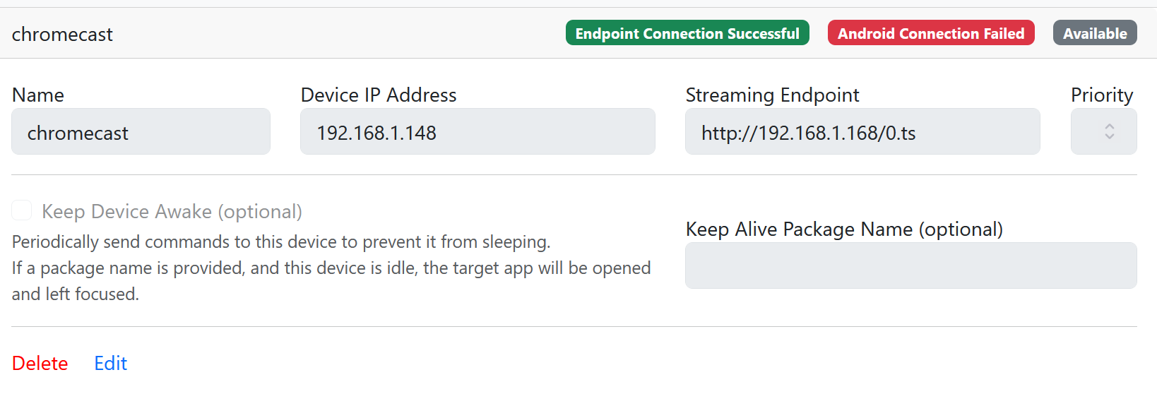

I swear I had this container working before, but I just tried reinstalling it and for whatever reason it will not connect to my chromecast. It sees the HDMI encoder, the chromecast does have developer mode enabled, and the synology nas that it is running on can ping the chromecast, but ADB tuner won't get past android connection failed.
Do you have USB Debugging enabled as well? Or, is there an device approval message waiting on the Chromecast device?
EDIT: Also, if your Chromecast device has updated to Android 14 it may no longer be suitable for ADBTuner. Search this thread for more detail on Android 14 related issues.
That is the error I saw when my chromecast devices upgraded to android 14. I had 4 that all quit working over the course of a week as they did automatic updates. No way to stop it updating or back it out. Android 14 is fine on ONN devices but Google broke ADB for the chromecast devices in android 14.
Yeah it's gotta be the Android 14 thing. Thanks.
