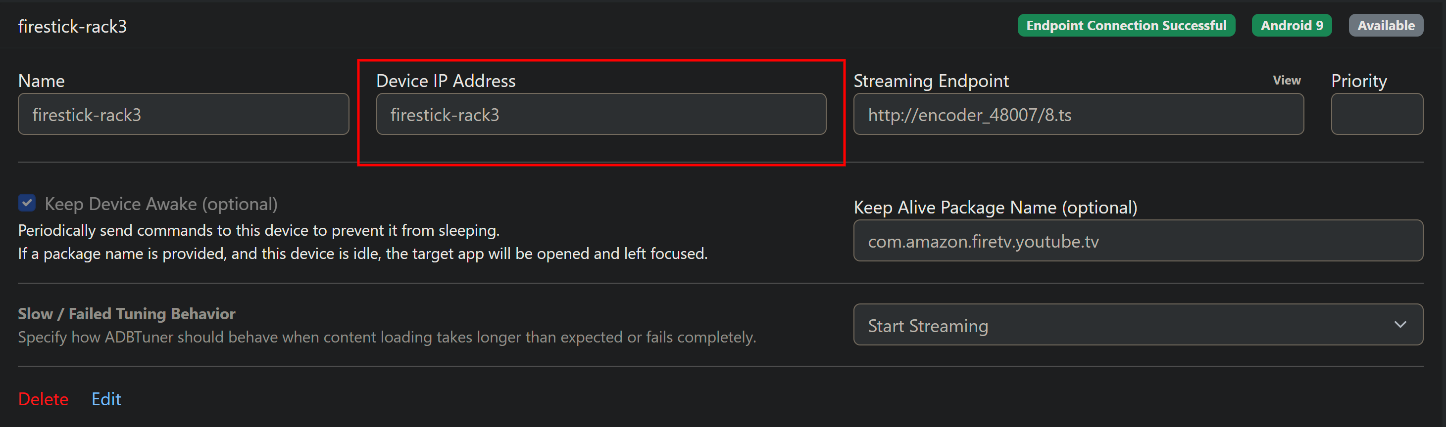

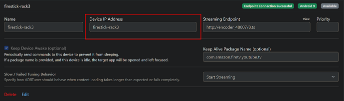

Yeah, of course. Are you looking for the "Device IP Address" associated with the allocated tuner? Or something else?
Yes, exactly. This value:
I just pushed an updated development build (20251209-1).
@bnhf a new ||TARGET_DEVICE_IP_ADDRESS|| variable is now available for commands within custom configurations.

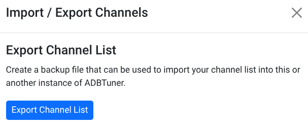

I'm looking to tidy up my ADBTuner setup by reorganizing my channels within the ADBTuner GUI. I know that I can use the export my entire channel lineup to a single JSON using the following function.
Screenshot 2025-12-11 12.42.43 PM
As I have a few different providers scattered throughout my channel list, I was wondering if there is a way to export a separate channel list for each service.
So far, I have been exporting the entire list and editing the JSON to create a separate JSON file for each source.
If that's the best approach, do any of you have a recommendation for a good JSON editor for Chrome/Android? I don't mind paying for a decent app. But, I don't want to get roped into a monthly fee.
