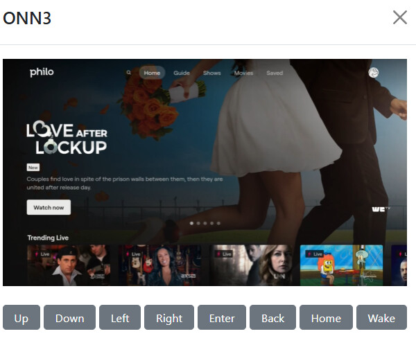

Not getting the "break" using my ONN, but it's not directly tuning channels anymore but just a general splash page (trying to tune Destination America):
