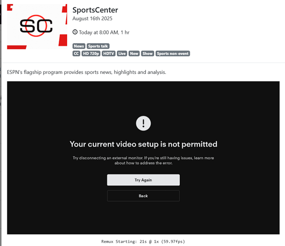

Having several issues with ADBTuner + 4 ONN sticks. First want to see what is happening when I try and watch ESPN/ESPN2, etc. One one tuner, I will get it to tune sometimes (other problem to solve for eventually), but for Tuners 2-4, I am seeing this in my encoders sneak-a-peak link when I try and tune to ESPN1/2 and something else is playing on Tuner 1:
I can tune other channels fine, but seems like the ESPN channels are hitting some handshake issue between the ONN box and the encoder ports 2-4 but not port 1?
So not 100% solved for me (timeouts), but it is MUCH better after moving off the VM to an actual hardware PC. Not sure why. It will still timeout sometimes when I try to load a channel in Kodi, but it seems to auto correct the tuner lock now after a minute or so, and it doesn't happen even remotely as often. It also seems to only happen on the FireTV stick, so I may move that down in priority so it chooses the Google Streaming box first.

So have mentioned previously I've been having some challenges with ADBTuner. As a reminder, here's my setup:
Streaming Devices: 2xONN (original boxes, ONN1, ONN2); 2x ONN4K (sticks, ONN3, ONN4)
4 Port HDMI Encoder
SynologyNAS for CDVR Server
Streaming Services: Fubo & Philo
Problem Statement 1: When I stop streaming a Fubo based channel through ADBTuner, it shows the tuner is released on the ADB admin page, but when I go into the HDMI admin page and do a sneak-peak, the channel simply has been paused.
Problem Statement 2: I also noticed that if I switch from a Fubo channel to a Philo channel on the same streaming device, the Fubo Channel will pause as usual, and then switch over to the Philo channel, but when I stop the Philo channel, the Fubo Channel I was watching will resume (not on CDVR, but in the background as confirmed through sneak-a-peak window on my HDMI Encoder webpage) not jus paused, but resumes live TV even though I didn't go back to that Fubo Channel to resume watching that channel through CDVR.
I have all Fubo based channels set to Deep Links Default and Philo based channels set to Compatibility based on previous comments I've seen in this group.
Basically in the example, I tuned into ESPN, stopped, tuned into Destination America, Stopped and ESPN popped back up in the sneak-a-peek window of my HDMI encoder even though ADBTuner said all tuners were released:

Do I have something setup incorrectly or is something else going on? I'm currently using the development version as it seems to be more stable than the others (I was having a lot of tuners locked after trying to tune individual channels).
EDIT1: was doing some additional testing and noticed this in the logs. Why is "pause" command being issued? This is a Fubo Based channel.
EDIT2: here's what is happening when a Philo based channel is stopped (goes back either to home screen if no preceeding Fubo Channel was being watched, or back to live Fubo if Fubo was paused when exiting the previous Fubo Channel):
I don't have Fubo but you could try using compatibility mode for it also since it sounds like Fubo channels are not releasing correctly.
Fubo is a mixed bag. I find more success using ah4c than using adbtuner but yeah try with compatibility mode. Fubo probably needs to be closed out first and then tuned in
Tried converting all to compatibility mode and seems to be working better.
ah4c requires a lot more in-depth knowledge than I have right now. May continue to tinker to see if I can get setup, but need a lot more free time and a "phone-a-friend" to work my way through that.

Issue 2: I'm now seeing this on ONN1 for ESPN whereas non-ESPN based channels I can still watch channels on ONN1 (ie NFL Network). Assuming ESPN is DRM and something has happened to the "handshake" between ONN1 and the hdmi encoder? I believe a reboot of ONN1 will solve the problem, but trying to figure out how to prevent in the future as Channels/ADBTuner can't tell it's displaying a warning vs. an actual live stream so ADBTuner isn't trying to switch to one of the other 3 tuners.
TIA

Were all of these playback attempts from Channels DVR, or were you using the web interface or another player? I'm curious as to why a disconnect was detected prior to the stream starting. It looks like there was a disconnect and then it immediately tried again which picked up another tuner.
I haven't seen anything like this before. What HDMI device are you using? It seems to be acting as if HDCP isn't supported?
I believe this can show if you reach a stream limit. Some channels have limits on how many streams you can have, less than what the provider allows for other channels. Very common with Sports channels. Ate you using your service anywhere else?
No, not streaming at other locations. Also, since ONN1 shows the warning but if I tune ONN1 to say NBC and then try and watch ESPN and ADBTuner uses ONN2, then it tunes fine. Leads me to believe it's a handshake issue of some sort.
Generic 4x hdmi encoder bought off eBay (link) some time ago. Supports HDCP as ONN2 - ONN4 will tune just fine. I've expeerienced this before on ONN2 & ONN3 and a reboot of the boxes solves the issue. Just trying to figure out what is causing the issue to pop up from time to time.
I used Web Interface as I can have multiple sessions going by opening up several tabs. Agreed it's odd, especially since the first box is actually tuned in (verified by having the hdmi sneak-a-peek on when I tune to a channel on that ONN box) but ADBTuner still tries additional boxes as if the ONN box didn't actually tune in.
