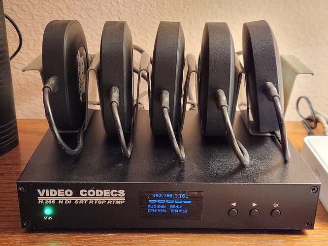

This post might help you visualize what's required. Here, I'm showing an HDMI encoder and multiple "streaming sticks" all connected using Ethernet and powered by PoE+. This represents the ultimate approach, with power controlled via PoE+, and connectivity at its most reliable via Ethernet:
There are plenty of more basic approaches as well, but this one is exceptionally robust for both local and remote use.
My setup is more on the budget side of things. I have a WayPonDEV Link Pi ENC5-V2 5 Port NDI HDMI Encoder, and Five Onn 4K Streaming Devices.
You can even make do with less than this. There are single port encoders, which can be used with a single tuner device or 2 tuners if you add a cheap USB HDMI capture device to the USB port on the Encoder.
