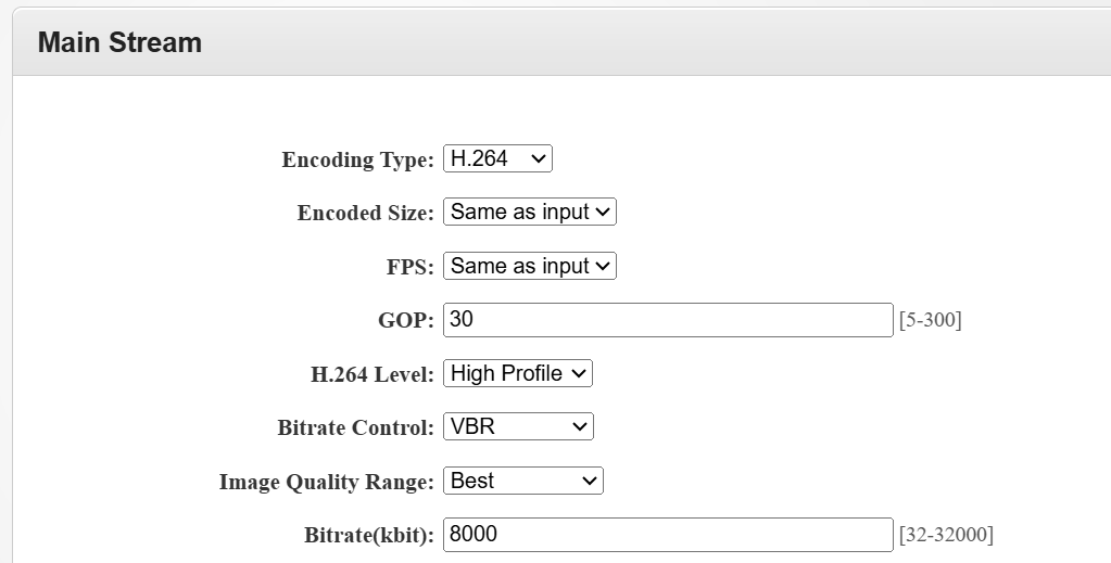

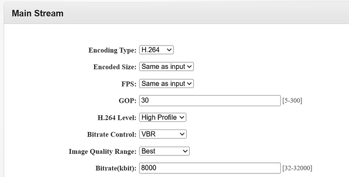

Is anyone having their streams buffer on Android TV? I have a Shield, everything is wired and I get random buffering with both of my encoders. The only thing that has fixed is to force transcoding on the DVR server (I'm running in Docker on Unraid with Intel QuickSync).
What settings are you using on your encoder? Encoding type, FPS, GOP, etc? I recently had to reduce the GOP on mine from 60 to 5 to get smooth playback in Multiview on an ATV 4K 1st gen.
This is how I have both of my encoders set! I've been pulling my hair out trying to dial this in right! Thank you for responding :slightly_smiling_face:!
I'd definitely try a GOP of 5, the theory being it reduces the decoding load on the client. You could also try CBR instead of VBR, and lower the Bitrate to 6000. Personally, I was surprised changing the GOP did the trick for me -- but it did, and makes no difference otherwise.
Keeping your bitrate and other settings high, and then turning around and transcoding to get things working right, is clearly not the answer. :slight_smile:
Oh I know it's not the answer!! I just could not figure out a solution. I'll test 5. Thanks so much!!!
Setting the GOP to 5 looked terrible. But 15 and then forcing a high strong CBR seems to take the stress off the decoder while compensating for the lower GOP without creating too much blocking. So far I'm testing on my Pixel 9 Pro XL with no stutters. I would imaging streaming full res over Tailscale from work as if I were home would definitely cause hiccups.
