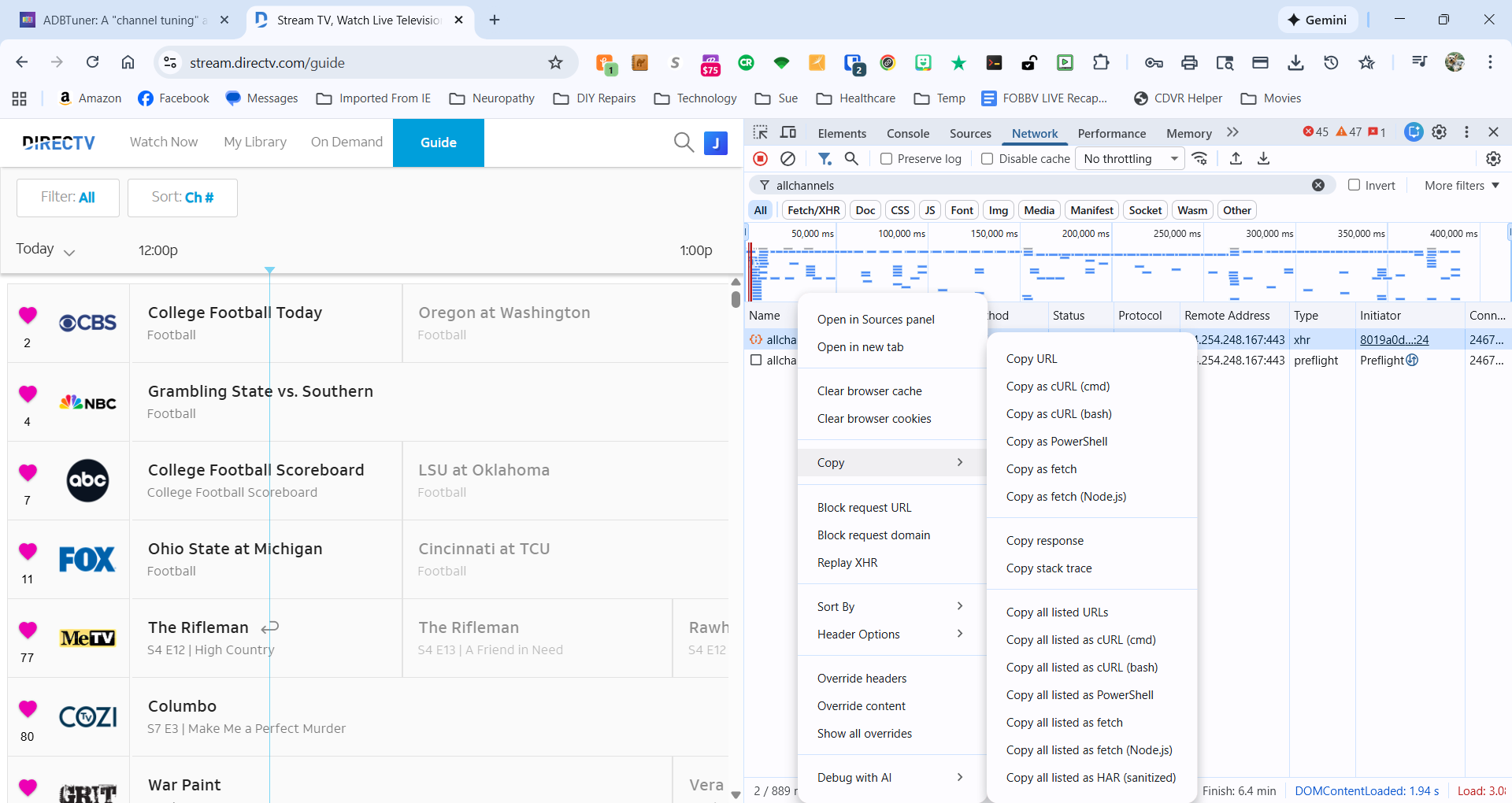

I'd love to grab the basic guide info you need to make a full channel list JSON for everyone to use. I made it this far, and don't know what to do next... @spammedeeper ?

@mackid1993 , I have captured the info which you will need to create an importable DirecTV channel list. Problem is, there are far too many characters to include in a post or message through this forum. Is there another way for me to send you the file? It's about 800 KB.

Let me know if this works, I'm not sure that I did it quite right, but we'll find out pretty quickly.
Just back up your current config before you try importing this. If I made any mistakes, just let me know and I'll correct them. It should be pretty easy to make changes.
Oh, and let me know if any Gracenote IDs are wrong. I'll correct them.
Edit: updated with @spammedeeper's custom config.
