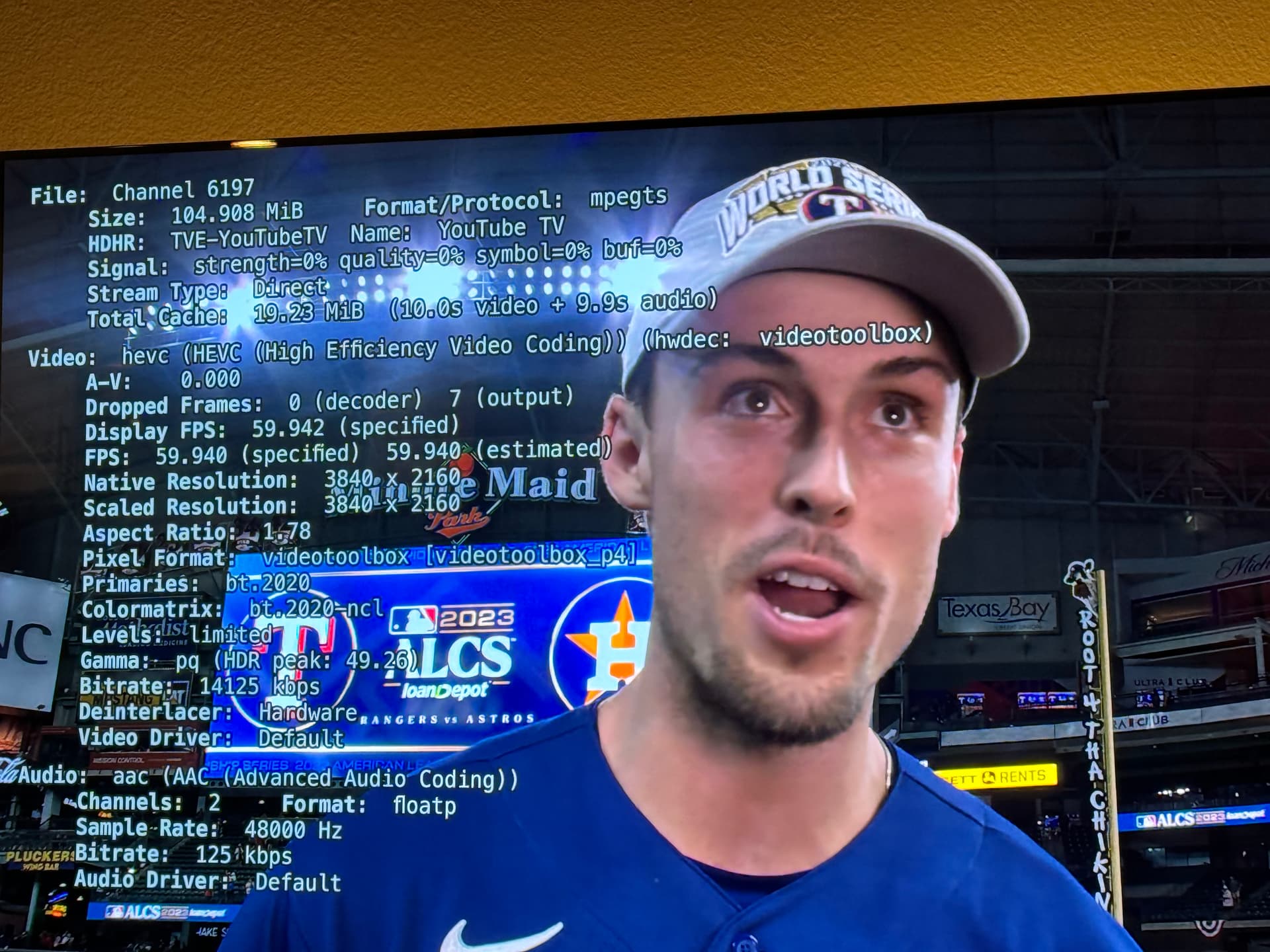

Here’s yesterdays game started late, it’s 2.5 hours you can do the bit math. Looking back it looks like that’s the bitrate for the baseball games. Maybe it was football that had 20s or I’m mistaken about 20.
holy smokes, batman! I can confirm that is true. I found this thread and checked my recording and found it was 3840 by 2160. I'm on Comcast in PA.
Here are some of the details.

That 1080 stat is wrong. It might be because the recording started on a commercial
I don’t think you will have a problem with 50gb, the 4k baseball playoffs are averaging about 5GB per hour.
