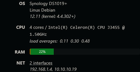

I was using my @bnhf debian version of the Channels DVR docker and it worked.
Screenshot 2025-12-07 at 09-46-38 Channels Settings

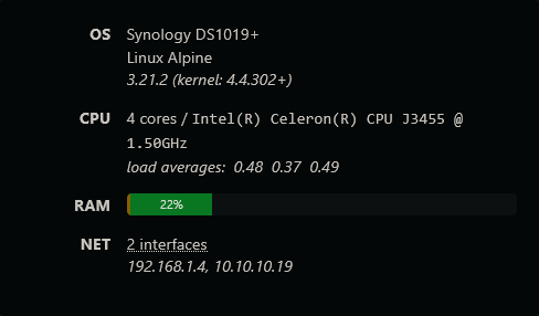

Using the regular Channels DVR tve version (Linux Alpine), it doesn't work.
Screenshot 2025-12-07 at 09-46-52 Channels Settings
