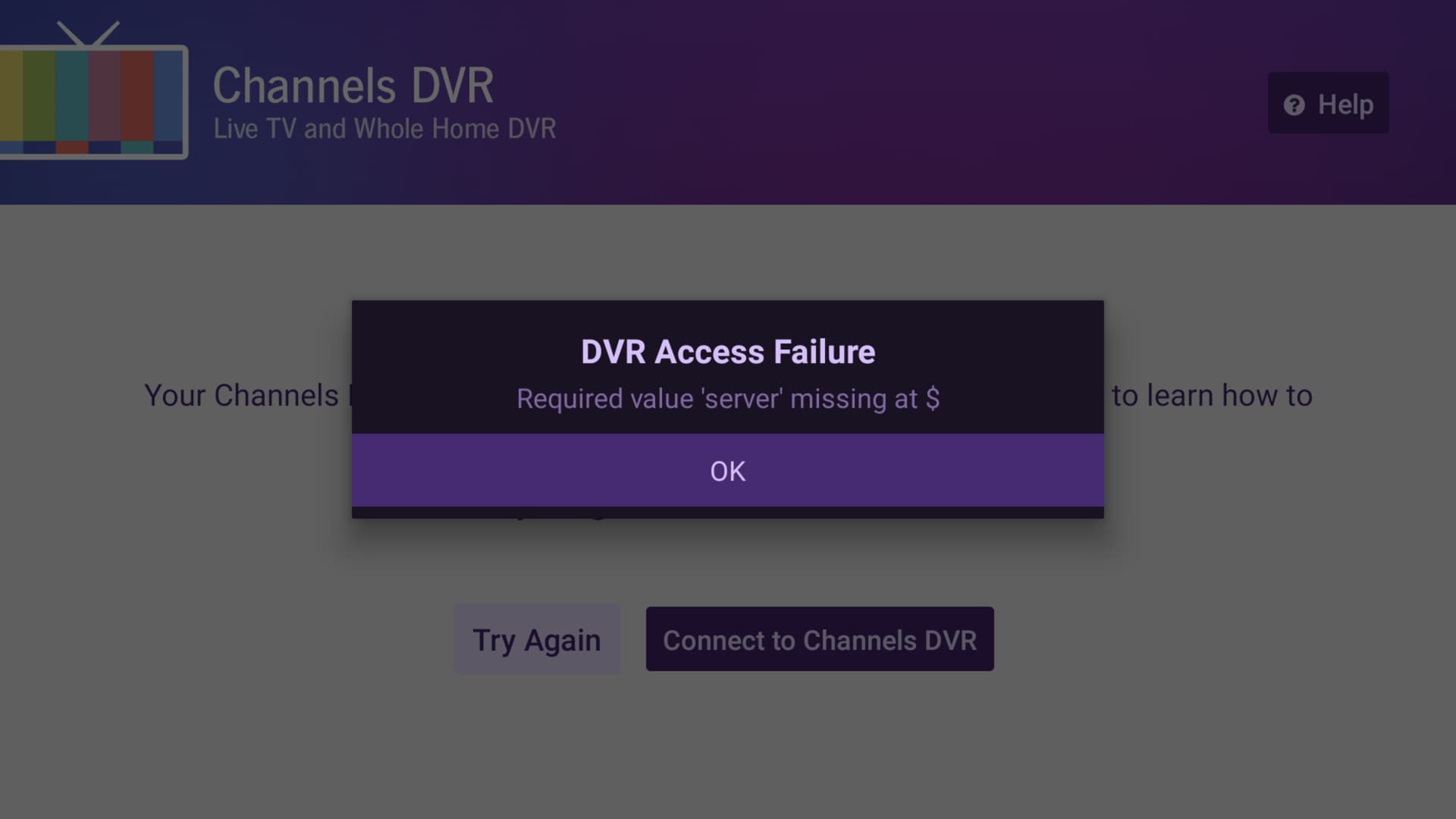

I updated to the latest Android beta client 7.25.2049 and it's still unable to establish a remote connection.
I am now getting an error message before I am able to athenticate the connection to the server.
"DVR Access Failure" "Required value 'server' missing at $"
I have submitted logs from the client, and server logs are 073d2705-8579-4cdf-8afd-8147b75c0fda .
That did the trick! Remote access seems to be working as it should. Thank you!
