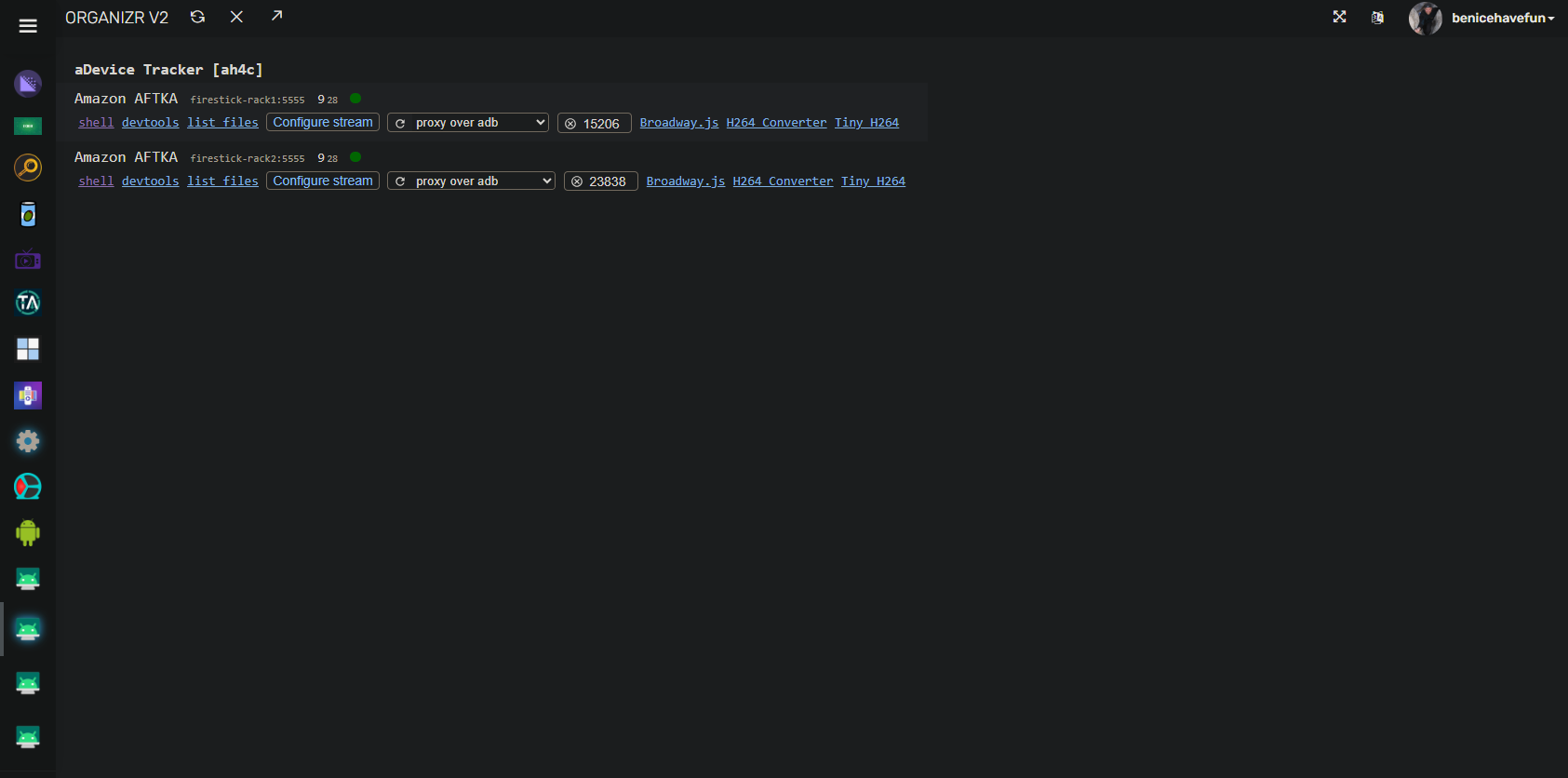

As of Android 11, adb authorizations have an expiration -- which you can override. You can use ah4c's built-in ws-scrcpy (usually on port 7655):
Click on the shell hyperlink for the box you want to shell into, and enter:
settings put global adb_allowed_connection_time 0
That should disable the adb auth expiry. If that works for you, which we probably won't know for 3-4 weeks, let me know and I'll likely add that to the ah4c startup script.

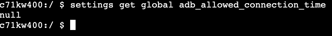

And, if you wouldn't mind, before you enter the above see what you get with:
settings get global adb_allowed_connection_time
Also, try that after you make the change too, I'd like to know the before-and-after values
Thank you! I did some googling a few weeks back and came across the commands. I applied the settings put global adb_allowed_connection_time 0 command to my Osprey Pendant Dongle which is the wi-fi only unit (Model: p21kw500). I did get a re-auth message on that box (today), but I have not applied it yet to my other 3 boxes which are typical osprey with wired ethernet (Model: c71kw400). I ran the settings get global adb_allowed_connection_time command you requested on the remaining 3 I haven't touched yet and it returns: null
I set the setting to 0 just now on the other 3 boxes, we'll see how they perform and I'll report back. Also the after value on the Pendant I changed already was 0 when I checked it. Does wi-fi have effect on adb re-auths?
null suggests to me the setting isn't implemented, but we'll see how it goes. WiFi vs Ethernet shouldn't have an effect on auths.
