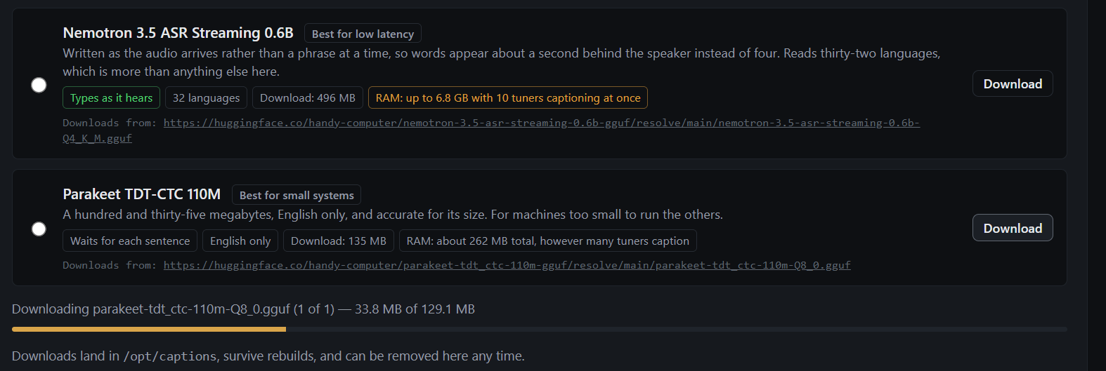

Only "quirk" I noticed in the ah4c CC UI, when downloading the model there was no progress bar, so the download button looked unresponsive. However after the download, the Green downloaded button appeared.

if you scroll down, there's a progress bar
