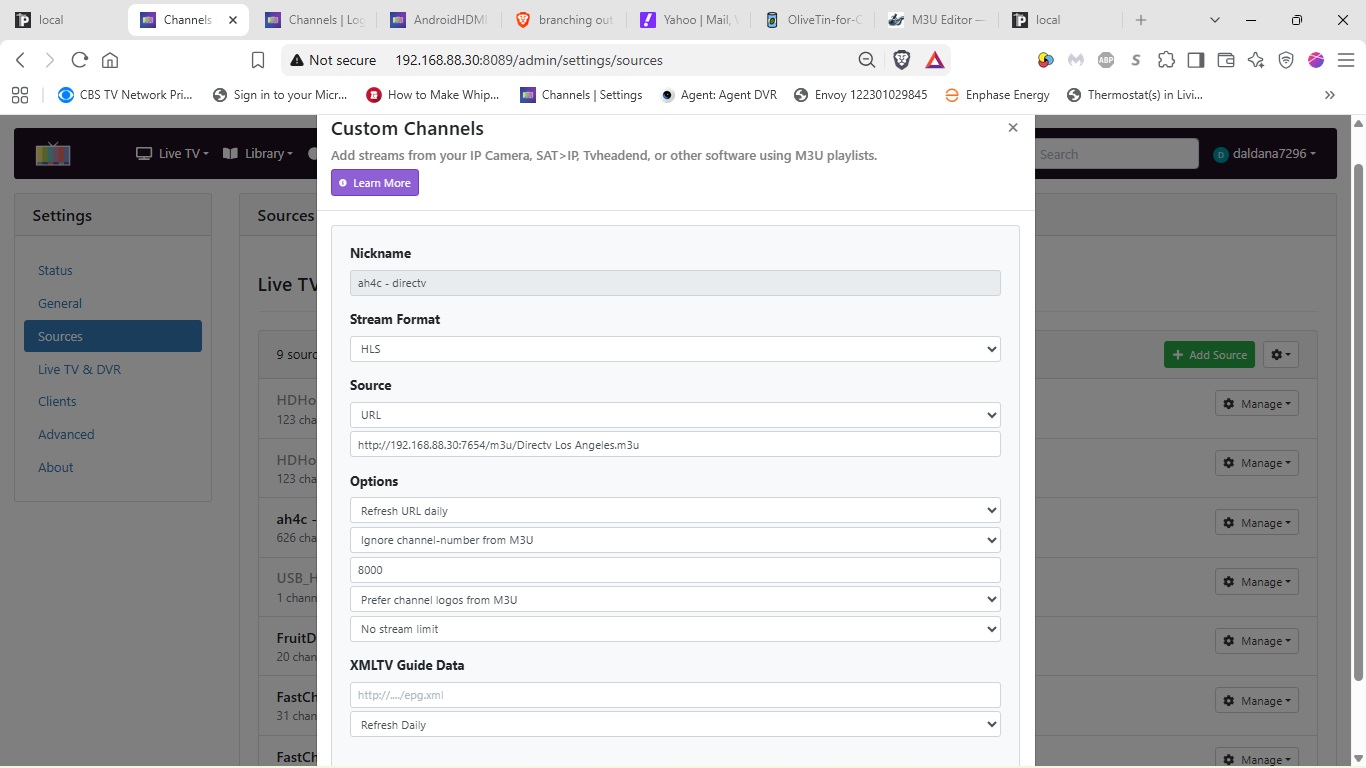

EDIT: Can you post a screenshot of your CDVR Custom Channels Source settings?

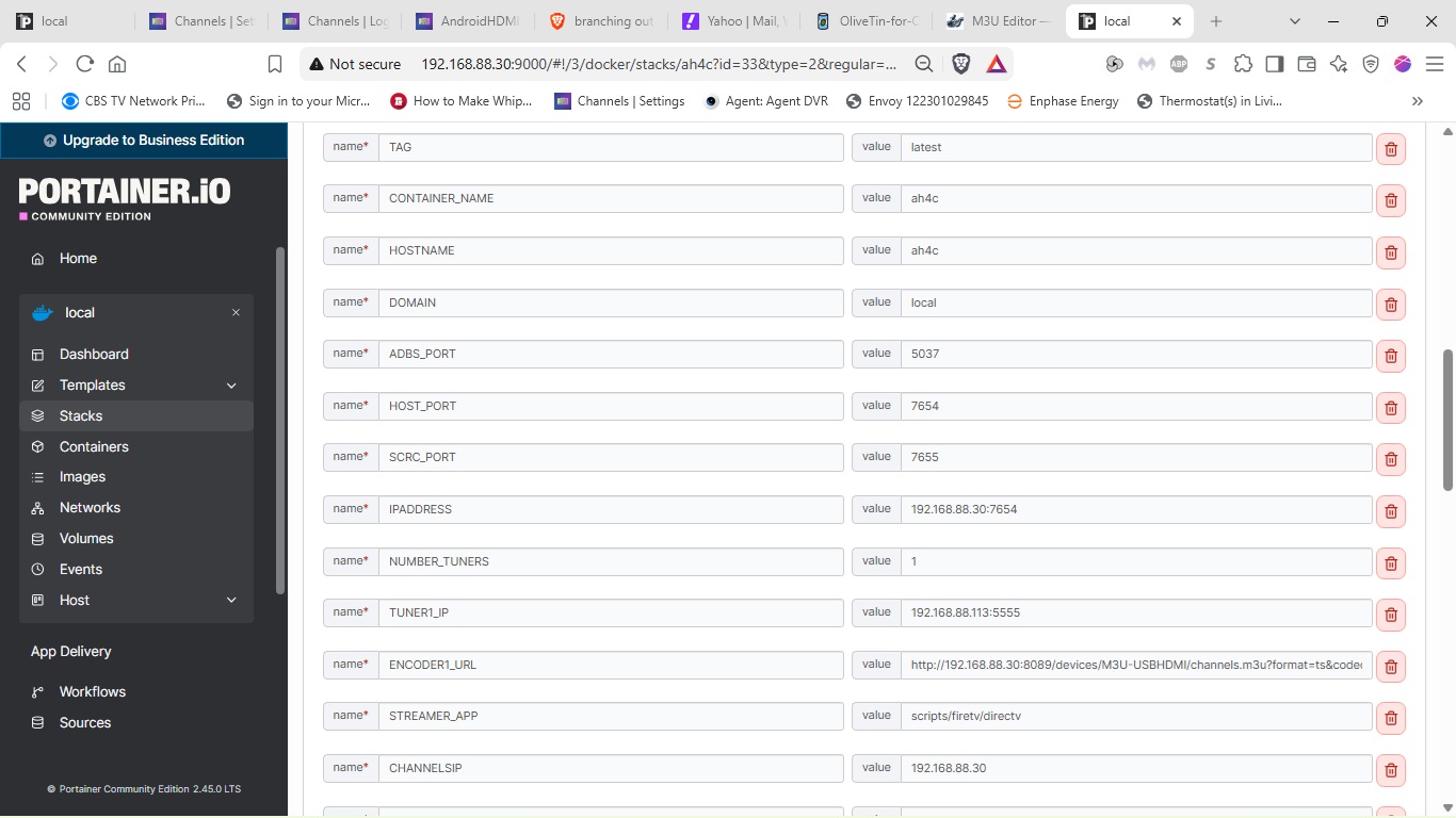

Also, your ah4c env vars might be helpful...

To answer your question, I'm not trying to use the other project to feed ah4c. Below are the screenshors.
What does your ENCODER1_URL value represent? What's the device behind that?
In the USB HDMI thread, @tmm1 gave directions on how to use a single capture card (like the one for the Windows Android ADB project) with ah4c.

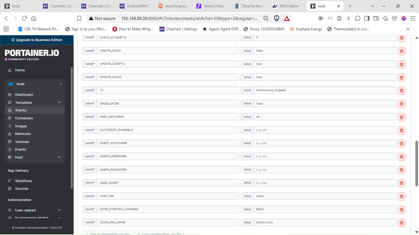

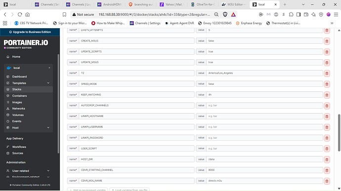

I'll call issues out as I see them:
The first is that your M3U URL can't have spaces in the name. Think Linux, not Windows.
The second is that your env vars tell me you're likely not using the latest Docker Compose. Upgrade to that, and modify your env vars accordingly. You can either do that in Portainer, or delete the ah4c stack and reinstall with the latest version of Project One-Click (published yesterday).

Change your STREAMER_APP value to scripts/firetv/dtvstreamdeeplinks.
