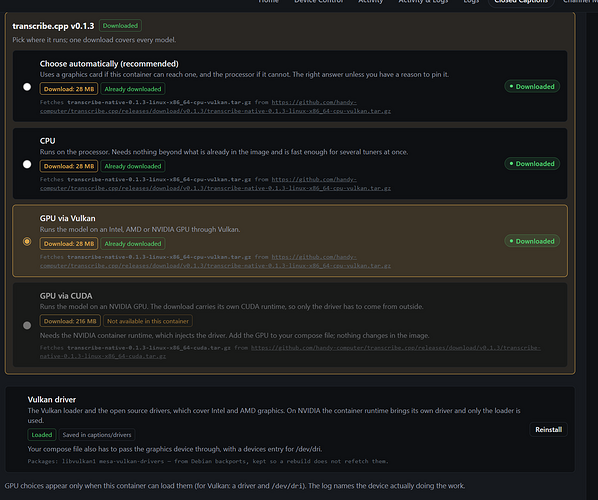

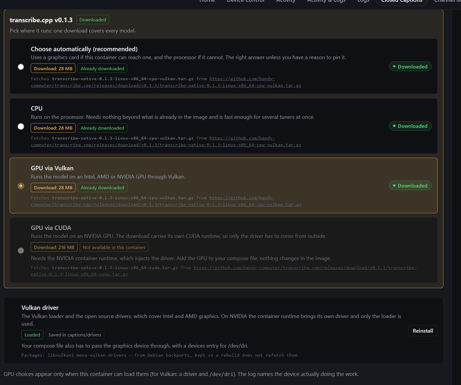

I installed the docker using Compose Manager Plus. I took the opportunity to use the tuning shell scripts as supplied instead of the versions I had been using (my own code). On a like-to-like comparison, I can see that it seems to tune faster and be more stable. Some configuration tuning was required, as I am on FireTV devices with Xfinity as the source (slow tuning is always a concern).
At this point I tried turning CC's on. I was able to generate captions using CPU-only as before. When I tried using the GPU, I got the same messages as with the original docker, "cuda backend requested but not available."
I have tried referencing the Nvidia card directly, as well as trying the "--gpus=all." and get the same results either way. The container also goes into a state where no captions are generated, not even via CPU. The CC config screen then tells me to restart the container, and that starts the cycle again. For now, CC are turned off. CPU-generated CC are too resource intensive.
So, back to my original question, What can I do to triage what is going on, if I open the console while the container is running? I am familiar with the "nvidia-smi", but that does not really tell me anything that I don't already know, i.e. the container is not using the gpu.
Share your compose and env in full. Also screenshot
edit: try this obviously tweak to your setup

hey - appreciate the reply but tried adbtuner as you suggested and got it working. if it doesnt work out i'll try yours again. as a longtime user of channels dvr who relied on tv everywhere i've been lost. what you are doing is amazing!
I don't believe that's true. The standard compose with the correct overrides will handle it. In fact that's the whole idea with this type of compose.
In fact your suggested overrides, with the standard compose, should be fine as-is.
Oh I've found (at least with my custom CDVR container I built for Unraid) you must remove /dev/dri before adding runtime nvidia. I could be wrong but I tested that briefly.
If you look at the standard compose we pass /dev/null as the default, which is never an issue. /dev/dri is an override and should only be used when supported, which in this case you wouldn't use.
Ah you're right. Then I really have no idea on this one.
Actually, I think what you proposed is very much worth trying -- but no need to change the standard compose.
@gellee00 try these env var overrides (adjusted as needed for your setup) with the standard compose:

EDIT: If that doesn't work, change this one line, and try again:
NVIDIA_DRIVER_CAPABILITIES: compute,compat32,graphics,utility,video,display

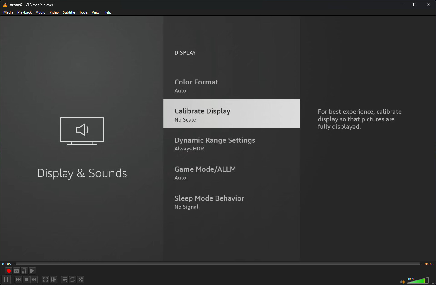

I've noticed that I don't get video in fullscreen. Is there something I need to check?
When you use your virtual encoder URL in VLC does it look the same?
Just checked and yes it does look the same.
So that tells us the virtual encoder is delivering the stream this way. Maybe the capture card has some settings that can be adjusted, or modifiers added/removed from the URLs you're using in the setup?
EDIT: Is it close to full screen? If so, the FireStick itself has some adjustments that may be able to deal with this:
I changed my display resolution to more than 1920x1080 and calibrated the firestick, now it looks better.
