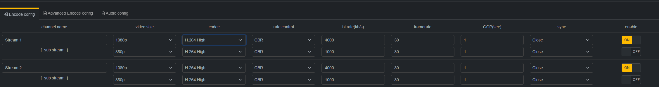

That firmware version I know to not be problematic.
So that doesn't look like it. The issue would be if you're encoding H.265 and you've got H.264 set.
This is what I have selected in the Link Pi, and h264 is in the .env if you didn't see that:
