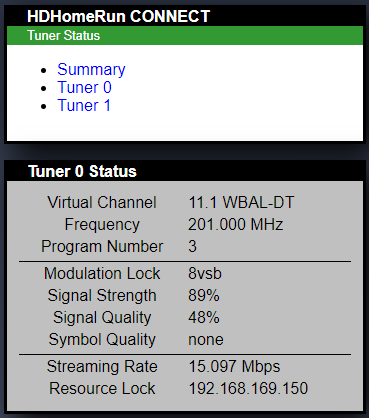

I thought I remembered a tool that let you see the signal strength, quality and symbols but I'm not finding that for Win10 now. Any pointers for where that is would be appreciated. Regardless, I was able to connect to the web interface and pull the stats while tuned into a problem channel. Here's what I got:
I'm not sure if the Symbol Quality is accurate, but it seems to be consistent for this channel. Other channels are coming up with 100% Symbol Quality. I seem to recall that was either 0 or 100.
So, I think I need to do something for this antenna. Just not sure if I should go amplified or bigger.

Nope. It can be anywhere in-between.
The tool you're seeking is the HDHomeRun Config GUI. It's something like hdhomerun_config_gui.exe or the like.
Probably not. 89% signal strength is more than adequate for 100% signal and symbol quality. You've got something else going on there. Either there's something awry with the transmitted signal (we had a station here that did) or you're getting a lot of multi-path.
I would raise this issue in the Silicon Dust forums, where SD's people will look at it. This is not a Channels issue at all. If it's the station, all you can do is reach out to them. If it's multipath, then perhaps it can be addressed with a more directional antenna or antenna re-siting.
