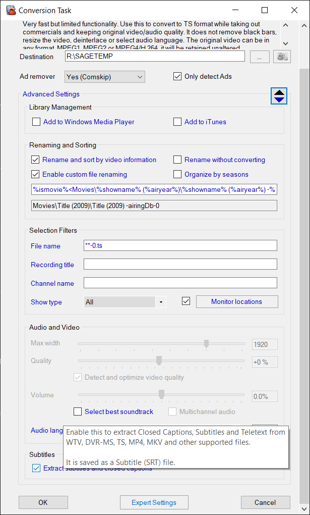

There is a setting to add Subtitles in mcebuddy. Look under expert setting in your task.
Screenshot 2020-11-17 194404
Thanks much.

Check your logs you should see this if it worked ... it is a good idea to always check the logs if something is not working. You can post a log and I can look at it.
Finished adding subtitles and chapters to file
You should also see this set to true ..
Embed Subtitles -> True
Embed Chapters -> True
Where can I find those settings? I'm not seeing them.
The picture I posted above make sure on your task that they are checked.
this is the way it looks in the log .

MCEBUDDY extracts the Closed Captions as a SRT then inserts them .. maybe the poster does not have to extract subtitles checked.
I've amended my settings to add subtitles, add chapters and extract closed captions as SRT files. I'm running MCEBuddy right now and will report on the results. I checked my logs, and had Embed Chapters -> False. I had already enabled add subtitles and extract closed captions as SRT files.

Okay, with the following settings, I'm getting embedded subtitles:
