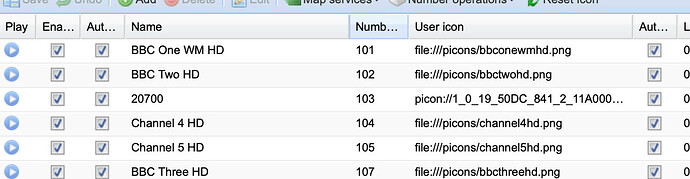

I'm trying to see if I can get it but for some reason TVH is not now mapping that bouquets channels.
Are you saying that you just don't have a channel 103 / ITV HD at all now?

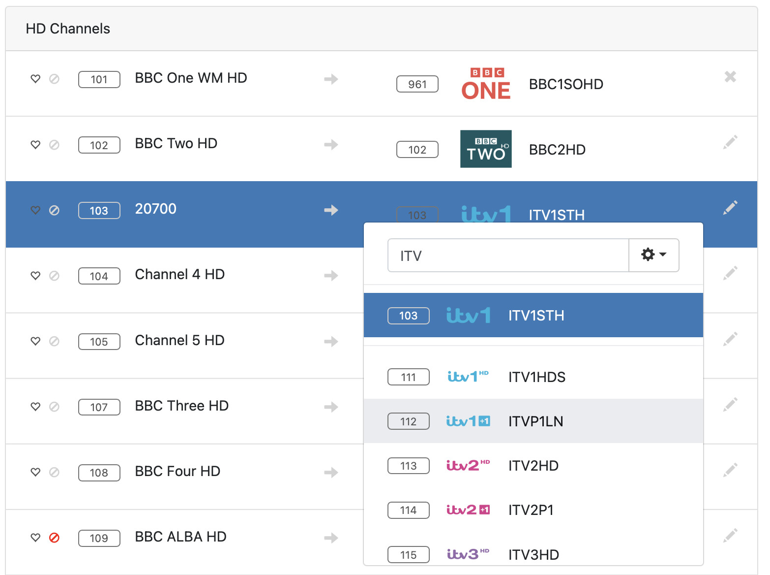

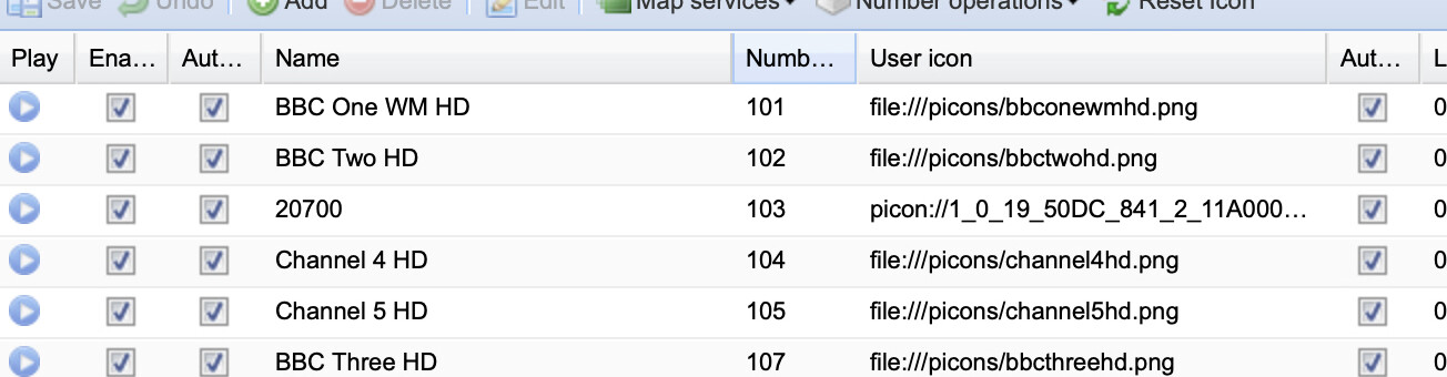

OK, finally got it mapping that bouquet and can see in TVHeadend that it is getting a channel 103, but for some reason it is not picking up the name (or icon). If you play it, it is the right one. Maybe this is related to what @kyl416 said and it will update soon.
That means in Channels it also won't appear by name so maybe your mapping has been lost, but you can simply map Channel 103 - "20700" to the correct ITV1 EPG data for that channel.
Then in Channels the EPG for the chosen channel will be shown. The logo shown will depend on how you have the source set up.

FWIW, I have manually renamed the “20700” channel to ITV1 HD in TVHeadend & it seems to be working OK again for now, so thank you again for your pointers, it helped put me on the right path to getting my set up working again
