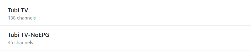

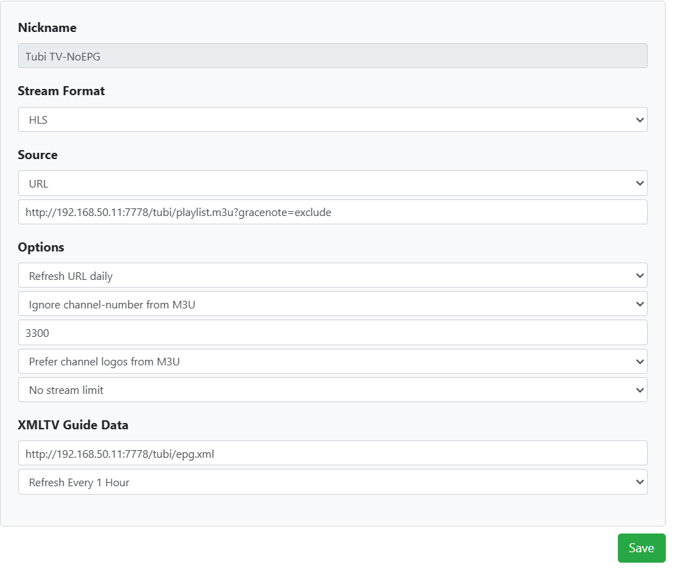

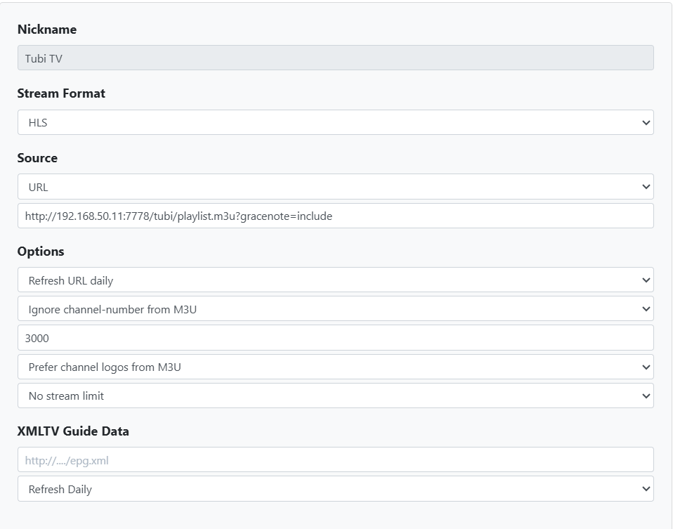

I use Olivetin ONE Click to create MY TUBI Source that way it is split up into 2 Sources one with grace note guide data that has 14 days. And the other is much smaller that has TUBI EPG. The NoEPG usually only has 1 day... I refresh the NoEPG every hour.
@TV_Ken You can slm to map channels that don't have EPG data to gracenote and the rest you can set to refresh every hour.

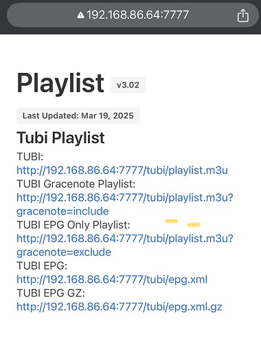

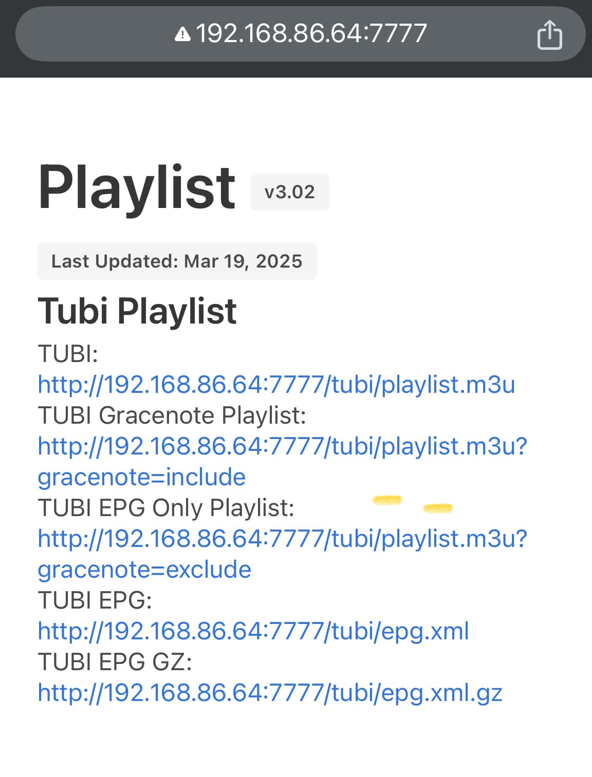

http://localhost:7781/tubi/epg.xml
Is there some setting that will get me the Gracenote data?
You don’t need the epg with the gracenote playlist.

I have Tubi and Pluto set to 1 hour, but every time I set Fubo to one hour, it resets itself back to daily.
What does "gracenote=include" or "gracenote=exclude" do? For now, I have set it to "include" to see what that does for me.

Uses the Channels DVR guide data which has the correct Series ID and Movie Categories. Also provides 14 days of Robust guide data.
Gets you guide data provided by Tubi for Those that do not have Gracenote ID's but might not have complete guide Info. usually missing Categories. Sometimes using the Tubi EPG will cause Movies to be recorded in TV Folder due to missing Categories.
