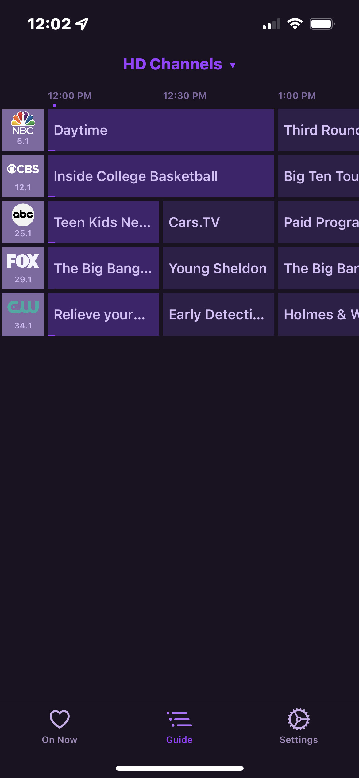

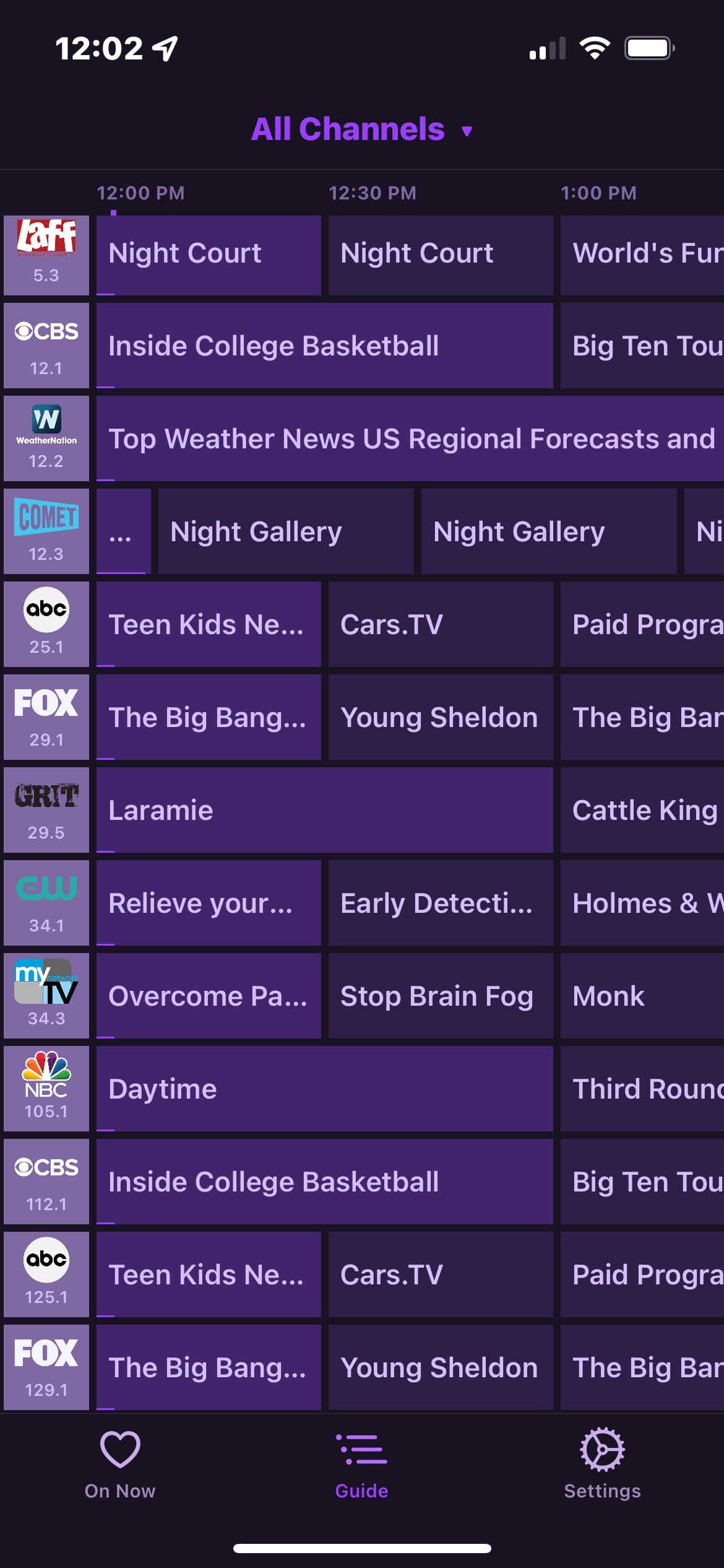

Noticed the Channels app on iOS/ATV/macOS only lists the ATSC 3.0 channels with the All Channels filter. Selecting HD Channels filters out the ATSC 3.0 channels.

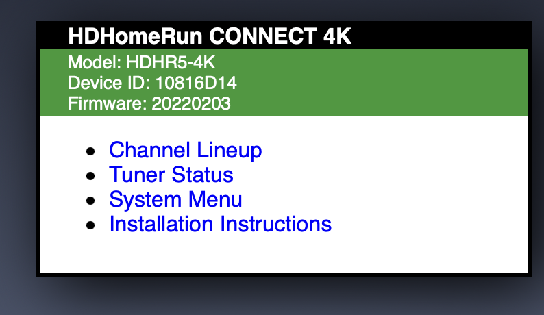

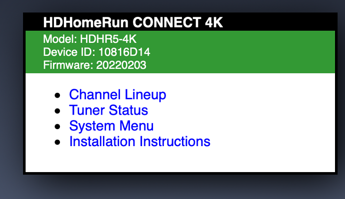

I believe you need to update your HDHR firmware. There was a bug that marked ATSC3 stations as SD.
I am running the latest firmware

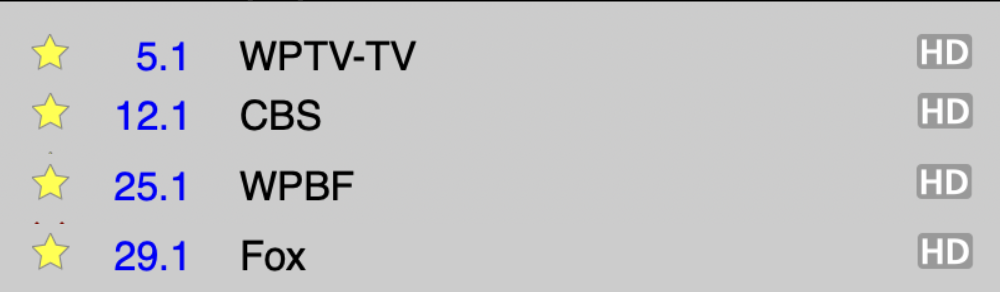

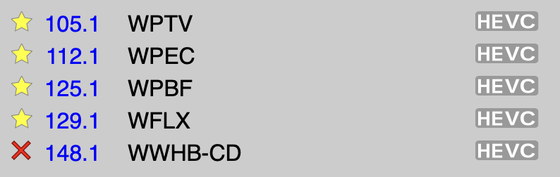

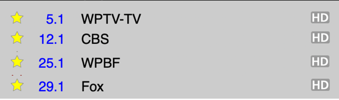

What do those ATSC 3 channels look like in the Channel Lineup view?

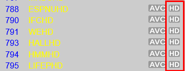

I don't have their ATSC 3 tuner, but on my Prime, the HD channels show a HD tag
Screenshot 2022-03-12 at 10-16-24 HDHomeRun Lineup
HEVC
Ah, OK.
HEVC is the video codec, like MPEG2 or AVC.
Appears they didn't add HD tags.
Do the ATSC 1.0 channels show the HD tag?
5.1
12.1
25.1
29.1
Yes.

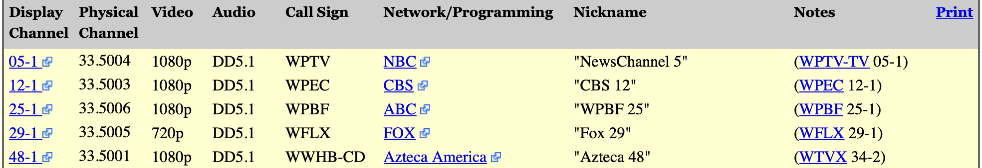

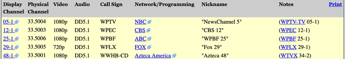

In my region, ATSC 3.0 broadcasts are a physically different tower, in a different direction, and on a different physical frequency from the ATSC 1.0 broadcasts.
