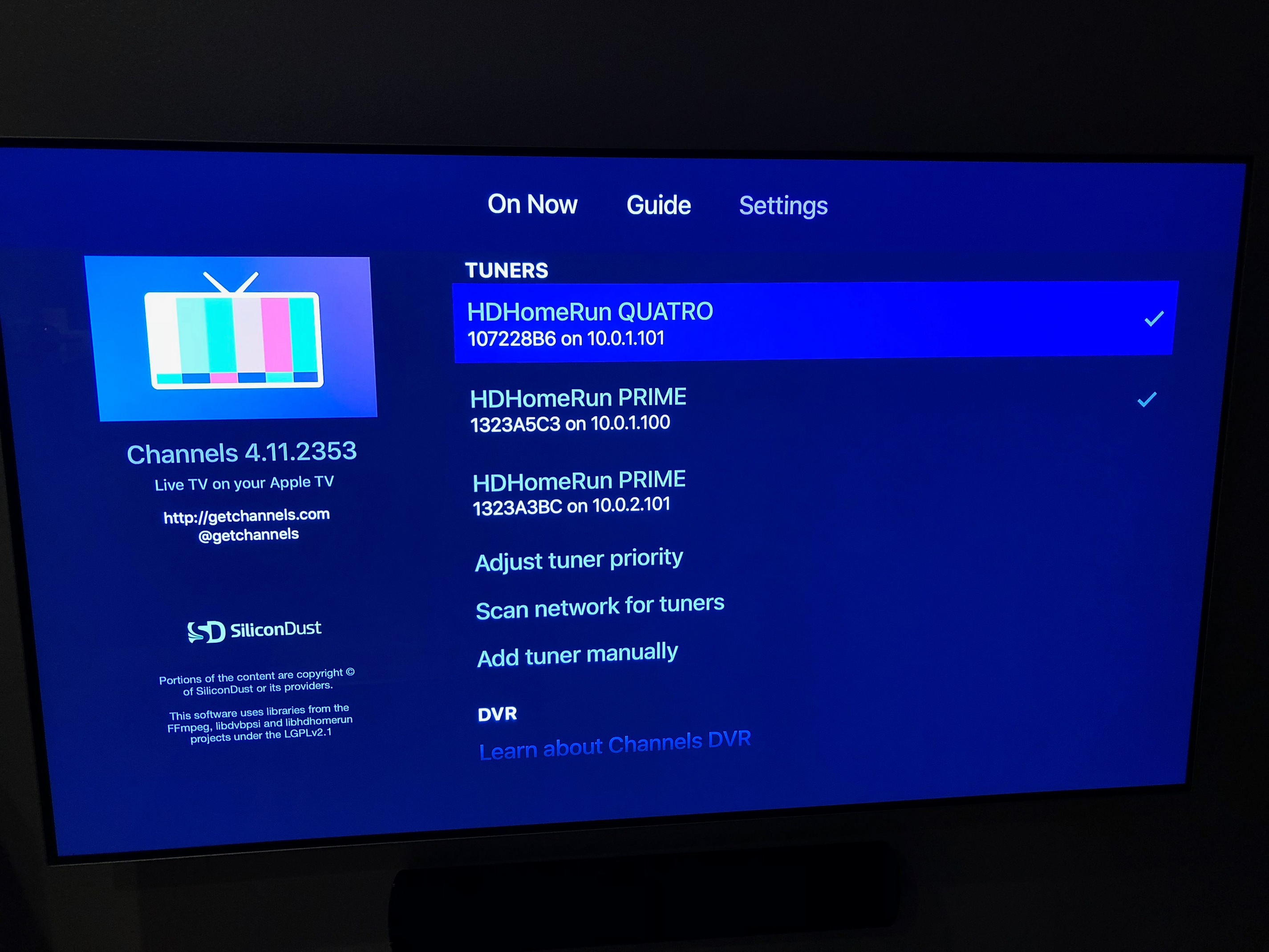

Updated to 2018.04.11.2353 and still no luck accessing DVR. I’ve submitted logs again. I do have IPv6 running, but the IP showing on the DVR page is just an IPv4 one. Only other thing I can add to this is my DVR and aTV are on different subnets, although it was never a problem with the previous versions of the app.
@dkrach doesn’t look like your upgrade completed…
I deleted it and reinstalled again from TestFlight, screen shows 4.11.2353, but same effect, no DVR.
You need to update your DVR server to the pre-release by holding down SHIFT and clicking Check For Updates.
@dkrach Please copy/paste the output from http://10.0.1.109:8089/system/network
It looks like the issue is because two different IPv6 subnets are in use, and the DVR can’t tell that they are both local. With IPv4 we know that all 10.x.x.x IPs are local, but that doesn’t work with IPv6.
Can you tell me more about how you have your IPv6 network setup? Did you define the two subnets yourself?
Here is the output… I assumed you wanted the DVR output which is at 10.0.0.253 (10.0.1.109 is the aTV).
