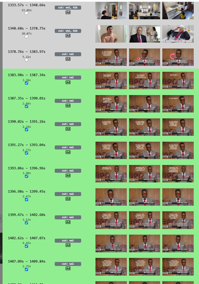

I too have had issues with the commercial skipping with my local news and ABC World News Tonight. I've been submitting corrections the past few weeks, but haven't seen any improvement. Sometimes the issue is with the "edit commercials" interface not allowing edits that are precise enough. (it will group the show and a commercial within the same block with no way to split it).

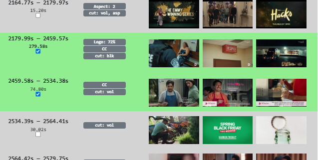

@eric Why would these tiny little segments get flagged as show under enhanced commercial detection?
Show: TV/Mighty Cruise Ships/Mighty Cruise Ships S02E03 2017-02-26 Viking Sea 2026-04-07-1100.mpg
The crazy thing is if I select standard they are not selected. I'm finding that with some shows, standard detection is much better than enhanced (usually for non primetime stuff)

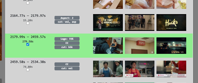

Here is another one:
Show: TV/Contraband Seized at the Border/Contraband Seized at the Border S02E07 2023-11-27 Crying Uncle 2026-04-07-1059.mpg
This is enhanced:
This is standard:

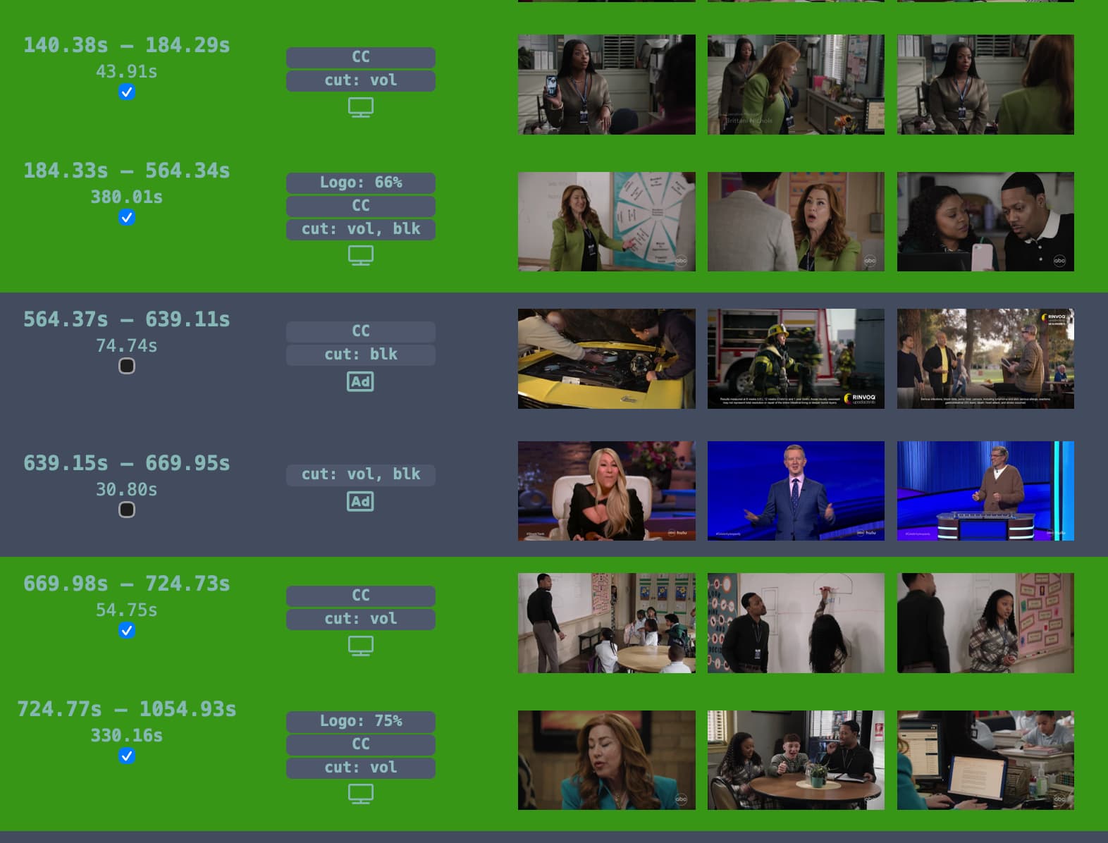

Was verifying commercials on a recent recording, and while the last frame is the last frame of show segment shown in the commercial editor is of the show segment, there's about at least 90 seconds of commercial included after the last frame of show shown.
@TheDaveAbides Yes, as we talked about previously in this thread, the segmentation we are using comes from the comskip project that we have always been using. Improving the segmentation is not something that is part of this initial work, but is something we hope to tackle some time in the distant future.

I'm confused what the issue is that you're reporting, in that case. Are you saying that the segmentation is fine but the commercial editor is picking the wrong frame to display (one that is outside of the segment)? If that is the case, that would be unrelated to the enhanced commercial detection and we can start a new thread to look into that.
Ding ding!
I was under the impression the last frame was much closer to the actual end than 75% of the way through. That's not as helpful on longer segments. Enhanced did help on this recording, I just personally prefer to know if the detected segment had commercial at the beginning or end.

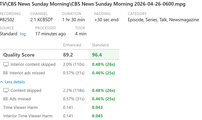

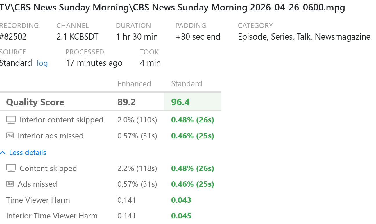

The only program that I commonly edit is CBS News Sunday Morning. I have yet to see a day where the enhanced detection outperformed comskip. Usually enhanced is considerably worse. Today it came fairly close.
Usually, comskip misses a couple of bumpers. It almost always marks the last part of the People Who Died This Week segment as a commercial. Enhanced always seems to err on the side of marking a significant portion of program content as commercials. Today was a bit unusual in that a 30-second commercial sandwiched between two program segments was marked as program content.
Thank you for doing this. News is our lowest category for edits. Getting more for this unique show layout will help us make it better.

I submitted dozens of edits for my local news and ABC World News but recently gave up because I wasn’t seeing any improvements. It’s become too difficult to submit edits because of the way the editor groups segments together. It’s not “specific” enough and I didn’t want to submit bad edits when both the show and commercials are grouped together.
