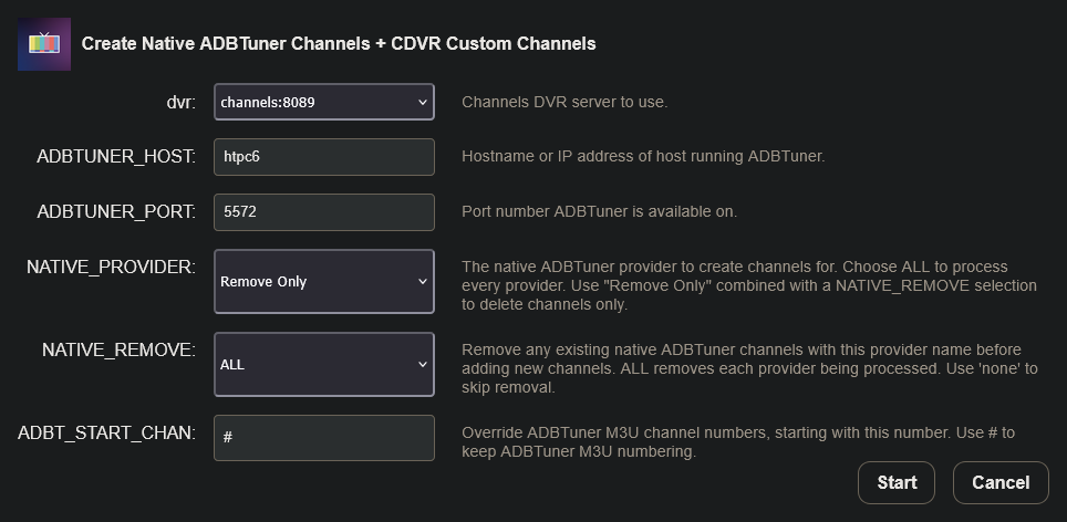

@babsonnexus Done, and pushed as bnhf/olivetin:latest (aka bnhf/olivetin:2026.07.30). I've updated the logic so that whether channels from this project are added one provider at a time (app_* provider names), or all at once (native provider name), when you select ALL for NATIVE_REMOVE all previously added channels from this project are removed.

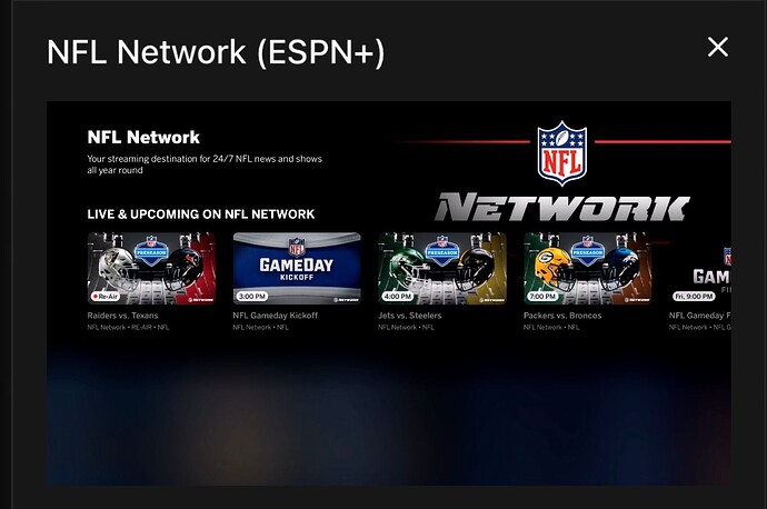

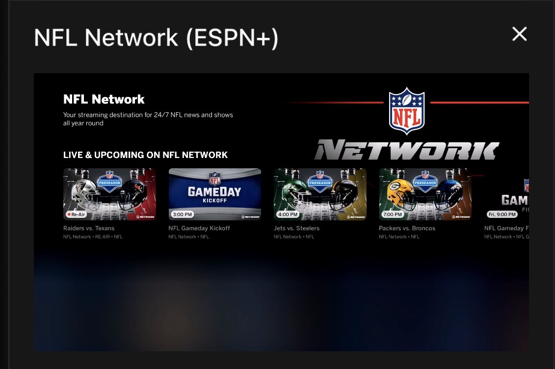

Any suggestions for getting the NFL Network channel to live tune via app_espn. I get as far as the channel landing page but stall at that point. Unlike other channels the live feed does not appear at the top of the page but it is always the first tile in the row.
Thanks!
Please make sure your ADBTuner container is up to date on the latest development tag and that your configurations have been refreshed. There have been a number of recent changes that are directly tied to this specific situation. I just tested to make sure everything is still working as expected, and it is on my end.

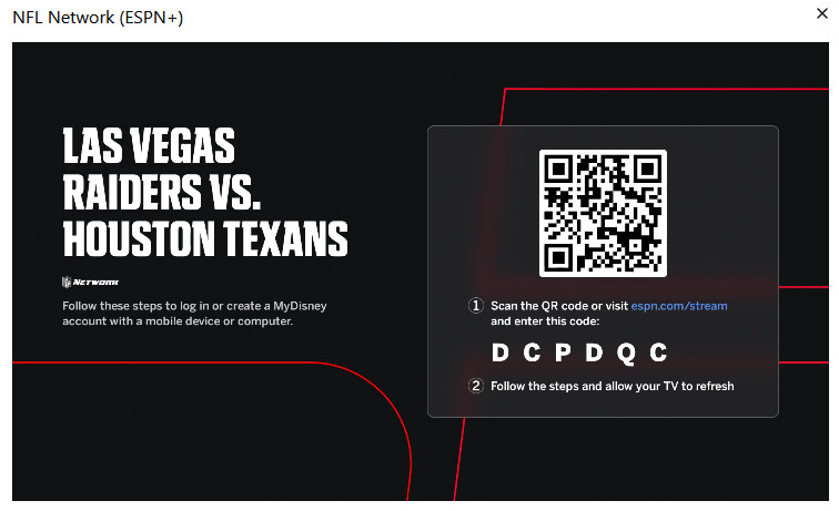

Further, as a reiteration of what's on the Wiki and in the release notes, please be aware that NFL Network on the ESPN app requires a direct ESPN subscription, not a TVE subscription. If you don't have that, you'll end up on this screen:
If you need to use the TVE option, you must use the NFL app version of the station (of which there were also a number of recent updates to accommodate app tile behavior when there are live games).
