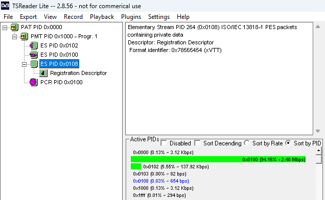

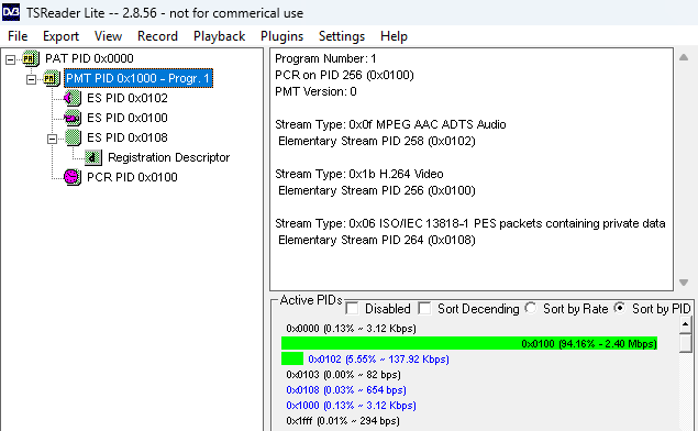

The text of the WebVTT captions are being remuxed into the MPEG-TS directly to work with the rest of our infrastructure.
Oh okay.
So webvtt recordings will work (display subs) within channels clients - but not outside? I assumed you meant for m3u export it wouldn't be visible - but are you meaning recordings?
Correct. The way they're muxing them into the MPEG-TS is using a private data PES of type xVTT that is not going to be used by anything other than their client players to extract them.
No other players or cc/sub rip utilities will work.

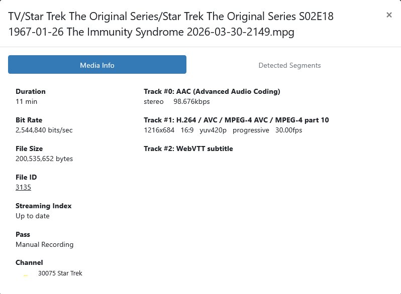

Screenshot 2026-03-31 092633
Screenshot 2026-03-31 092559
Pluto Recording > View Details
