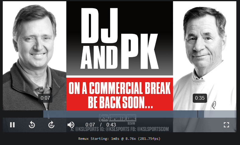

If you inspect the "Channels", they have exposed m3u8's that could be integrated as custom stations:
So long as there is no DRM, you should be able to add them. I tested one, and here's it working in Channels:
