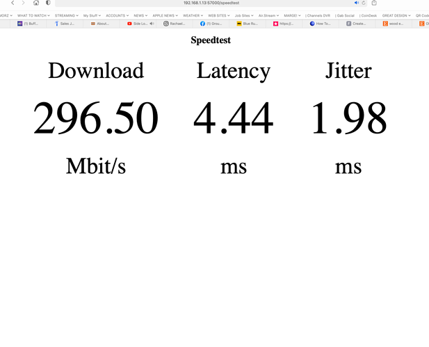

The app is struggling to download the video file from your DVR. Try running the speedtest again while you're experiencing the issue to see if it shows a lower number.
If the network speeds are still fine, then that would suggest maybe your Disk speeds on your DVR machine are maxing out.

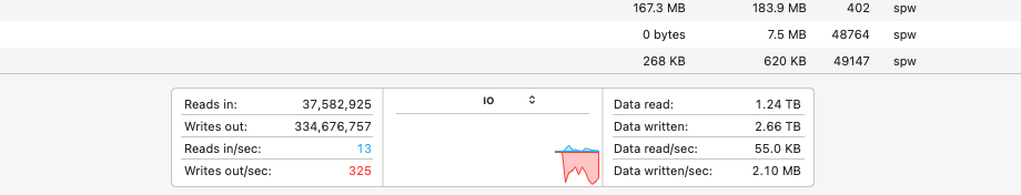

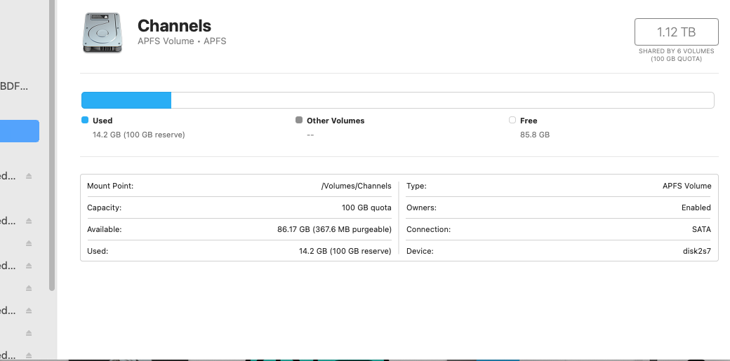

QUESTION.... could this be due to the "partition" I made to keep the data on my drive?
Check Activity Monitor > Disk to see if the disk is overloaded
What else is happening on those disks. You have 1.12TB shared between 6 volumes
Not sure... how would I check?

Your network is fine so the problem is with the disk.
The disk is not fast enough or is it overloaded or the way you have it setup is causing problems.

I reinstalled it from the partition to the main drive... it's a 1TB Fusion setup...I think the dick is a 7200 and it has an SSD that is not accessible.
