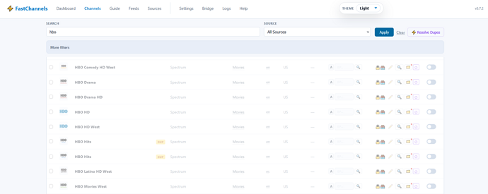

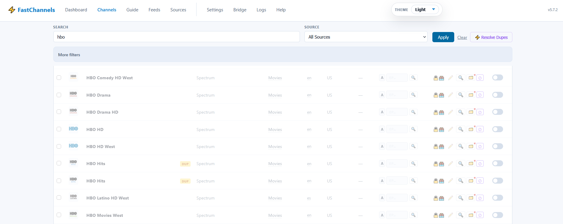

Right now, the HBO stations are not in FC unless you're using something like Spectrum and have access...
... but I expect that to change in the near future. In the meantime, you can continue to use HENA to get them from the app, but I won't be updating for any changes that may come in the future.
Yeah...HBO Max links are a bit direct as its deeplinks and the default configs are enough to pipe it in.
Sad to see HENA discontinued but FAST Channels have a more direct way of piping in DRM'd channels (especially if you have a small-town cable provider).
