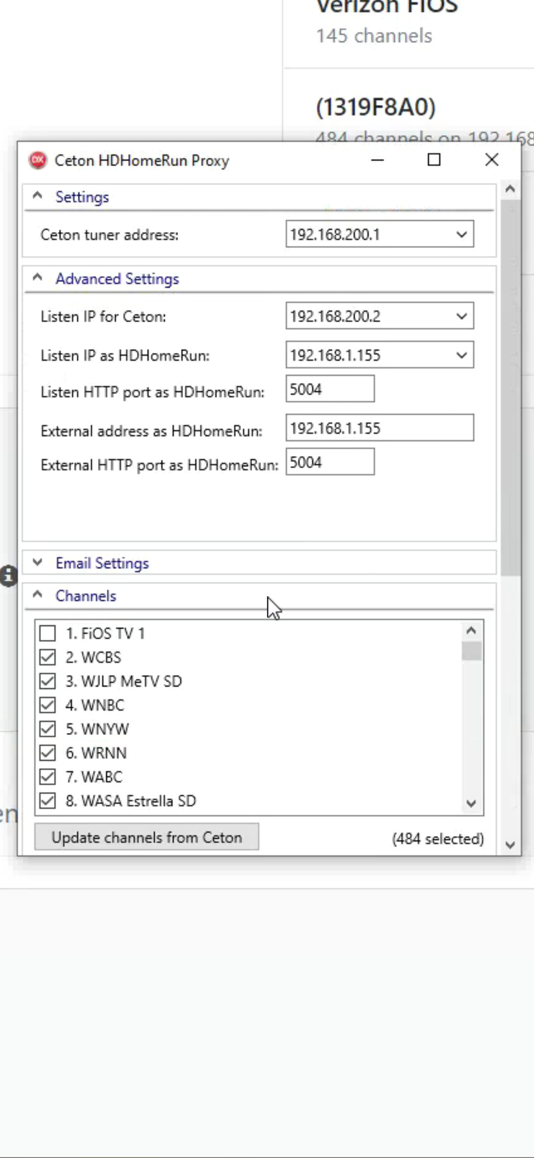

Cetonproxy is lacking in that you can't designate tuned channels as DRM, HD, AVC, etc (similar to what you find in the HDHOMERUN dashboard). Because of that, all stations show up on the guide. Youll need to set favourites to address this

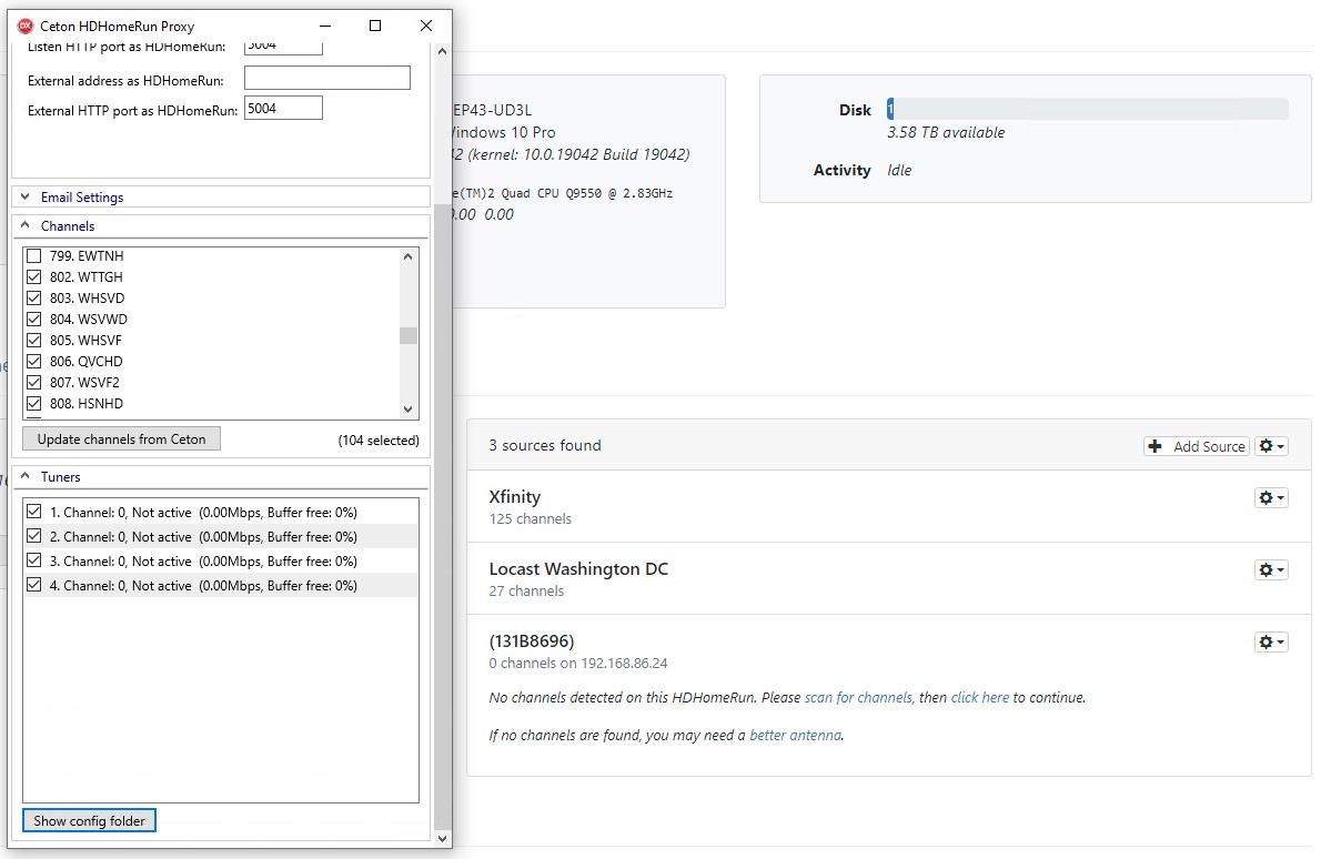

I hate to bring up an old topic but I just found this. I have run Cetonproxy and I have tested it how the developer of it suggested and all is fine. However, when I open up the Settings screen of my Channels DVR server (which I run as a service), it seems like it detects it automatically but calls it a strange name and says no channels detected.
Below is the setup screen for Cetonproxy and Channels. Any ideas on what to do? I have already started the computer just in case that was a suggestion.

Try adjusting your Advance Settings to direct it to the device instead of Auto. Also disable any firewalls that might be running, as cross network card communication could be hampered.
Theres always the low hanging fruit of forcing a Channels DVR update (holding shift while clicking Check for Updates). I know on an older version of DVR i couldn't get the channels to recognize and the developer pushed an update that solved it. Worth a shot.
The weird name thing you'll just have to live with. Cetonproxy developer isnt very responsive and ive yet to find where in the code i can adjust that.
I have done all that and still have issues. Everything works in VLC. You can see that in the screenshot below that shows tuner 1, tuned to channel 804. I started it in VLC. The settings in that same screenshot shows the only Ceton tuner in the dropdown list selected. I put in the IP address for the Ceton card in the Listen for Ceton section and the IP address of the computer that cetonproxy, ceton tuner and Channels DVR is installed on in the Listen as HDHomeRun as well as External address as HDHomeRun. I think that is what you are showing on your screenshot. HOwever for some reason, Channels DVR won't see the channels. I do have the latest version of Channel DVR installed too.
I also disabled my firewall.
I would really like to get this going but I am confused as to why this isn't working.
Thanks for the help!
