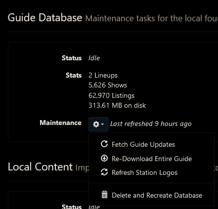

You can try what's mentioned in this post if the official HDHR app has the guide correct.
SHIFT click Sync Station Mapping
I would then delete and recreate the guide database.
Screenshot 2023-09-14 at 18-42-55 Channels Settings
