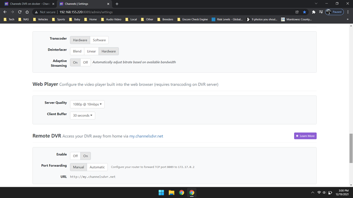

For anyone still looking for this, when I added the docker container to my Synology I put in " sudo docker run --device=/dev/dri -it fancybits/channels-dvr:tve " and got Hardware. Here's a link I went off of Using Containers with the Command Line
