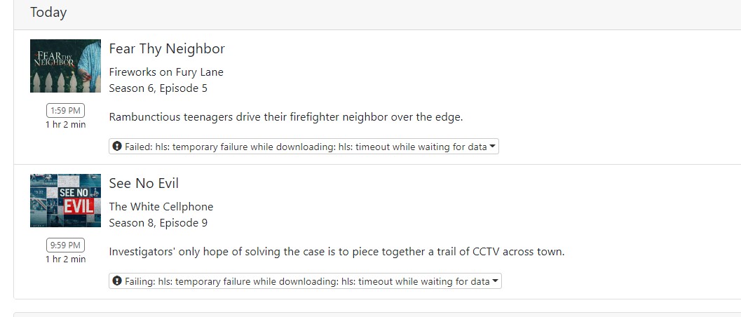

Can someone tell me what the error message means in the attachment. My system seemed to be working fine (was having some problems with recordings) but had not problem with everything else.
Today, while watching live TV, the picture would go off and I would get a "Playback failure (0)" error message. If I went back to the guide, the program would restart, but after a few minutes, the error screen reappeared.
While watching a recorded program, it kept stopping and starting every few seconds like it was buffering.
No clue what brought on these group of errors and problems. I have already rebooted my modem and router.
Any help or suggestions to get my system to start working properly again?

@loucille48 Looks like we had a regression that didn't retry properly when there was a timeout.
Please try the latest pre-release and let us know if it solves your issue.
