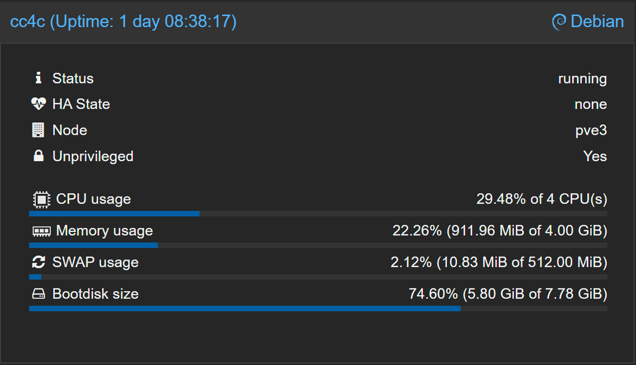

A couple of updates for those interested in a containerized version of chrome-capture-for-channels:
The first, which I reported a few posts ago, is that cc4c is running very nicely in a Proxmox LXC container with 4 vCPUs and 4GB of RAM allocated. Highly recommended for users with decent hardware running Proxmox.
The second, is that I built a new Docker container (amd64 only) based on the @dravenst cc4c repo, and that's also working very nicely. @dravenst appears to have really cleaned-up the cc4c code, with better error handling and improved performance. I'm testing this on a 10th generation i7, also with 4 vCPUs allocated and 4GB of RAM. Here's what resource usage looks like, including all overhead, with a single active stream:

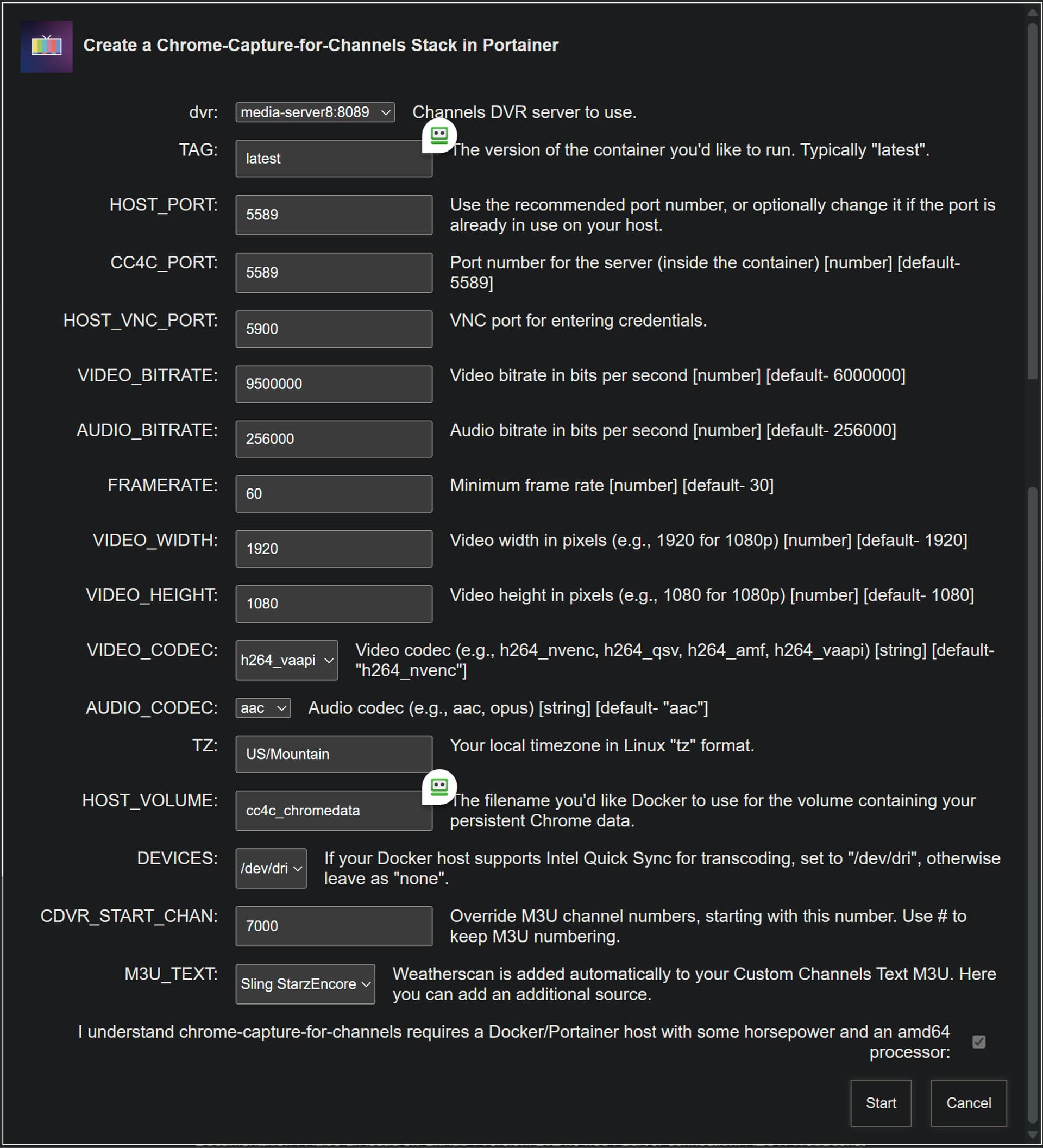

I've added Project One-Click support for the new cc4c Docker container based on the @dravenst repo. This includes spinning-up the container, and creating an initial CDVR Custom Channels wth the Weatherscan channel. As a bonus, if you have the Sling StarzEncore package, it'll add those 15 channels as well -- ready to use. Pushed this afternoon as bnhf/olivetin:latest (aka bnhf/olivetin:2025.04.13).
Tweak any values you need/want to change, and the Portainer Stack will be created for you:
And, as always with Project One-Click, the Custom Channels Source is created too:
