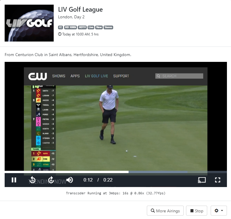

I have also tried to set up the CW, with limited success:
#EXTINF:-1 channel-id="CW",CW
chrome://localhost:5589/stream?url=https://www.cwtv.com/
The above isn't just the video, it ends up with other things as well. Has anyone gotten the CW to work?
Lastly, is it possible to get CC working?
I am able to enable captions for SOME channels in the chrome browser. It appears to be dependent on the source. I can enable CC on channels I am streaming from YTTV but not on NBS News. I'm not saying it can't be done, just that if it can, I haven't figured out how to do it.
The CW channel doesn’t support TVE or have a Live feed via the web…

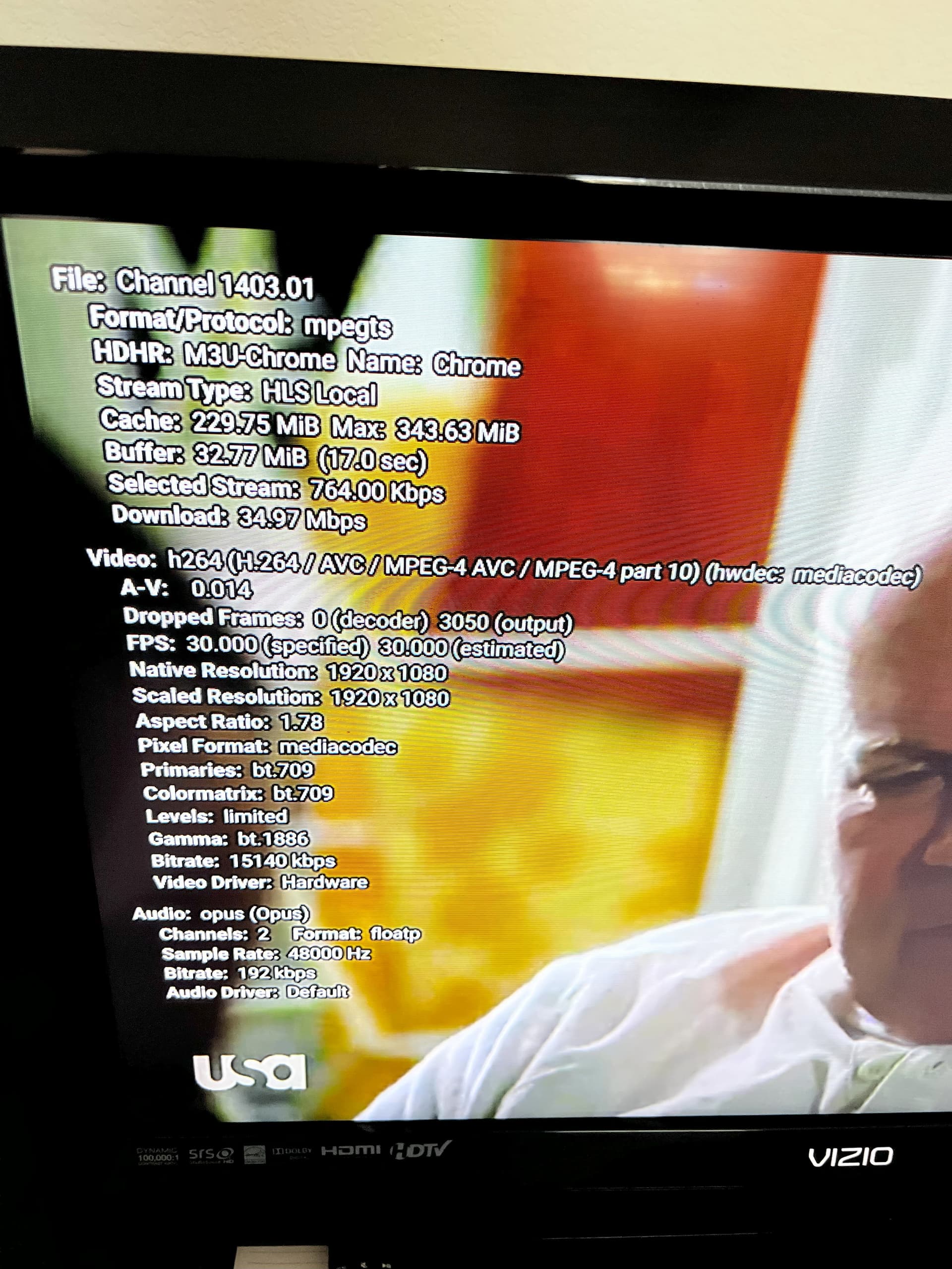

Looking at the stats for the Firestick - I am seeing a high number of dropped frames for CC4C output that I don't see elsewhere. Tried changing to HEVC for transcoding which improved slightly but still had output drops
