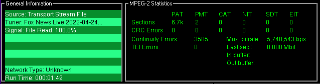

TSReader shows 3,585 continuity errors in the recording
TSReader

End logo block 2	frame 115752	Length - 0:06:09.98
Frame 115897 (2145.066s) - Black frame with brightness of 16,uniform of 0 and volume of -1
Frame 115898 (2145.082s) - Black frame with brightness of 15,uniform of 0 and volume of -1
Frame 115899 (2145.099s) - Black frame with brightness of 15,uniform of 0 and volume of -1
Frame 115900 (2145.116s) - Black frame with brightness of 16,uniform of 0 and volume of -1
Frame 115901 (2145.132s) - Black frame with brightness of 16,uniform of 0 and volume of -1
Frame 115902 (2145.149s) - Black frame with brightness of 16,uniform of 0 and volume of -1
Frame 115903 (2145.166s) - Black frame with brightness of 16,uniform of 0 and volume of -1
Frame 115904 (2145.182s) - Black frame with brightness of 16,uniform of 0 and volume of -1
Frame 115905 (2145.199s) - Black frame with brightness of 16,uniform of 0 and volume of -1
Frame 115906 (2145.216s) - Black frame with brightness of 16,uniform of 0 and volume of -1
Frame 115907 (2145.232s) - Black frame with brightness of 15,uniform of 0 and volume of -1
Frame 115908 (2145.249s) - Black frame with brightness of 15,uniform of 0 and volume of -1
Frame 115909 (2145.266s) - Black frame with brightness of 15,uniform of 0 and volume of -1
Frame 115910 (2145.282s) - Black frame with brightness of 16,uniform of 0 and volume of -1
Frame 115911 (2145.299s) - Black frame with brightness of 16,uniform of 16 and volume of -1
Frame 115912 (2145.316s) - Black frame with brightness of 16,uniform of 28 and volume of -1
Frame 115913 (2145.332s) - Black frame with brightness of 16,uniform of 61 and volume of -1
Frame 115914 (2145.349s) - Black frame with brightness of 16,uniform of 90 and volume of -1
Frame 115915 (2145.366s) - Black frame with brightness of 16,uniform of 107 and volume of -1
Frame 115916 (2145.382s) - Black frame with brightness of 16,uniform of 121 and volume of -1
Frame 115917 (2145.399s) - Black frame with brightness of 16,uniform of 130 and volume of -1
Frame 115918 (2145.416s) - Black frame with brightness of 16,uniform of 135 and volume of -1
Frame 115919 (2145.433s) - Black frame with brightness of 16,uniform of 140 and volume of -1
Frame 115920 (2145.449s) - Black frame with brightness of 16,uniform of 147 and volume of -1
Frame 115921 (2145.466s) - Black frame with brightness of 16,uniform of 138 and volume of -1
Frame 115922 (2145.483s) - Black frame with brightness of 16,uniform of 147 and volume of -1
Frame 115923 (2145.499s) - Black frame with brightness of 16,uniform of 138 and volume of -1
Frame 115924 (2145.516s) - Black frame with brightness of 16,uniform of 148 and volume of -1
Frame 115925 (2145.533s) - Black frame with brightness of 16,uniform of 156 and volume of -1
Frame 115926 (2145.549s) - Black frame with brightness of 16,uniform of 168 and volume of -1
Frame 115927 (2145.566s) - Black frame with brightness of 16,uniform of 153 and volume of -1
Frame 115928 (2145.583s) - Black frame with brightness of 16,uniform of 143 and volume of -1
Frame 115929 (2145.599s) - Black frame with brightness of 16,uniform of 131 and volume of -1
Frame 115930 (2145.616s) - Black frame with brightness of 16,uniform of 116 and volume of -1
Frame 115931 (2145.633s) - Black frame with brightness of 16,uniform of 108 and volume of -1
Frame 115932 (2145.649s) - Black frame with brightness of 16,uniform of 103 and volume of -1
Frame 115933 (2145.666s) - Black frame with brightness of 16,uniform of 86 and volume of -1
Frame 115934 (2145.683s) - Black frame with brightness of 16,uniform of 79 and volume of -1
Frame 115935 (2145.699s) - Black frame with brightness of 16,uniform of 79 and volume of -1
Frame 115936 (2145.716s) - Black frame with brightness of 16,uniform of 62 and volume of -1
Frame 115937 (2145.733s) - Black frame with brightness of 16,uniform of 48 and volume of -1
Frame 115938 (2145.750s) - Black frame with brightness of 16,uniform of 29 and volume of -1
Frame 115939 (2145.766s) - Black frame with brightness of 16,uniform of 19 and volume of -1
Frame 115940 (2145.783s) - Black frame with brightness of 16,uniform of 11 and volume of -1
Frame 115941 (2145.800s) - Black frame with brightness of 16,uniform of 4 and volume of -1
Frame 115942 (2145.816s) - Black frame with brightness of 16,uniform of 0 and volume of -1
Frame: 115943	Ratio: 2.38	MinY: 91	MaxY: 629	MinX: 1	MaxX: 1280
Frame: 115973	Ratio: 1.78	MinY: 1	MaxY: 720	MinX: 1	MaxX: 1280
Strange video pts step of 0.07040 instead of 0.04217 at frame 117413
Frame: 117413	Ratio: 2.40	MinY: 91	MaxY: 626	MinX: 1	MaxX: 1280
Frame 117608 (2214.523s) - Black frame with brightness of 18,uniform of 666 and volume of 2087
Frame 117609 (2214.565s) - Black frame with brightness of 17,uniform of 400 and volume of -1
Frame 117610 (2214.607s) - Black frame with brightness of 17,uniform of 400 and volume of -1
Frame 117611 (2214.648s) - Black frame with brightness of 17,uniform of 376 and volume of -1
Frame 117612 (2214.690s) - Black frame with brightness of 17,uniform of 270 and volume of -1
Frame 117613 (2214.732s) - Black frame with brightness of 16,uniform of 6 and volume of -1
Frame 117614 (2214.774s) - Black frame with brightness of 16,uniform of 0 and volume of -1
Frame 117615 (2214.815s) - Black frame with brightness of 16,uniform of 0 and volume of -1
Frame 117655 (2216.484s) - Black frame with brightness of 16,uniform of 0 and volume of 3104
Frame 117656 (2216.525s) - Black frame with brightness of 19,uniform of 153 and volume of -1
Frame 117910 (2227.119s) - Black frame with brightness of 16,uniform of 197 and volume of 1094
Frame 117911 (2227.161s) - Black frame with brightness of 16,uniform of 389 and volume of -1
Frame 117912 (2227.203s) - Black frame with brightness of 17,uniform of 488 and volume of -1
Frame 117913 (2227.244s) - Black frame with brightness of 17,uniform of 671 and volume of -1
Frame 117914 (2227.286s) - Black frame with brightness of 17,uniform of 1074 and volume of -1
Frame 117915 (2227.328s) - Black frame with brightness of 17,uniform of 1076 and volume of -1
Frame 117916 (2227.369s) - Black frame with brightness of 18,uniform of 1145 and volume of -1
Frame 117917 (2227.411s) - Black frame with brightness of 18,uniform of 1333 and volume of -1
Frame 117918 (2227.453s) - Black frame with brightness of 18,uniform of 1561 and volume of -1
[aac @ 0x6cc7240] env_facs_q 254 is invalid
Frame: 118133	Ratio: 1.78	MinY: 1	MaxY: 720	MinX: 1	MaxX: 1280
Frame Rate set to 29.970 f/s
DFps[1]= 59.940 f/s
RFps[1]= 59.940 f/s
AFps[1]= 60.000 f/s
Format changed to [1280 : 594]
Frame 118492 (2251.443s) - Resolution change from 1280 x 720 to 1280 x 594
Thanks for trying! At least I know it's not my build or hardware!
Maybe @tmm1 will get some time to chime in. Thanks in advance if you can!
Maybe when comskip crashes, the video file should be processed/cleaned up by ffmpeg and given another go?
