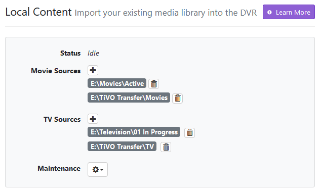

  1. Expose that directory in your Channels settings, similar to this:
  1. Let Channels discover the files and then correct any metadata misses:
