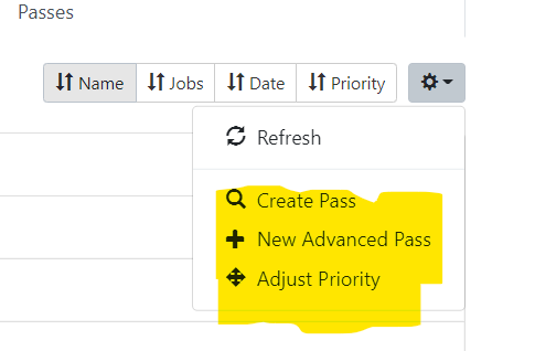

Also, when did the location of advanced pass editing change? I just had a devil of a time finding it.

Pass editing has been merged into a single modal.
If I go to DVR Passes and try to create a new advanced Pass nothing happens.
Nah, Fairfield.
Try the latest build that just went up. Things are changing around this.
Edit: Nope! It's broke. BRB.
Edit 2: OK, the new build hasn't landed yet, that's what's going on.
