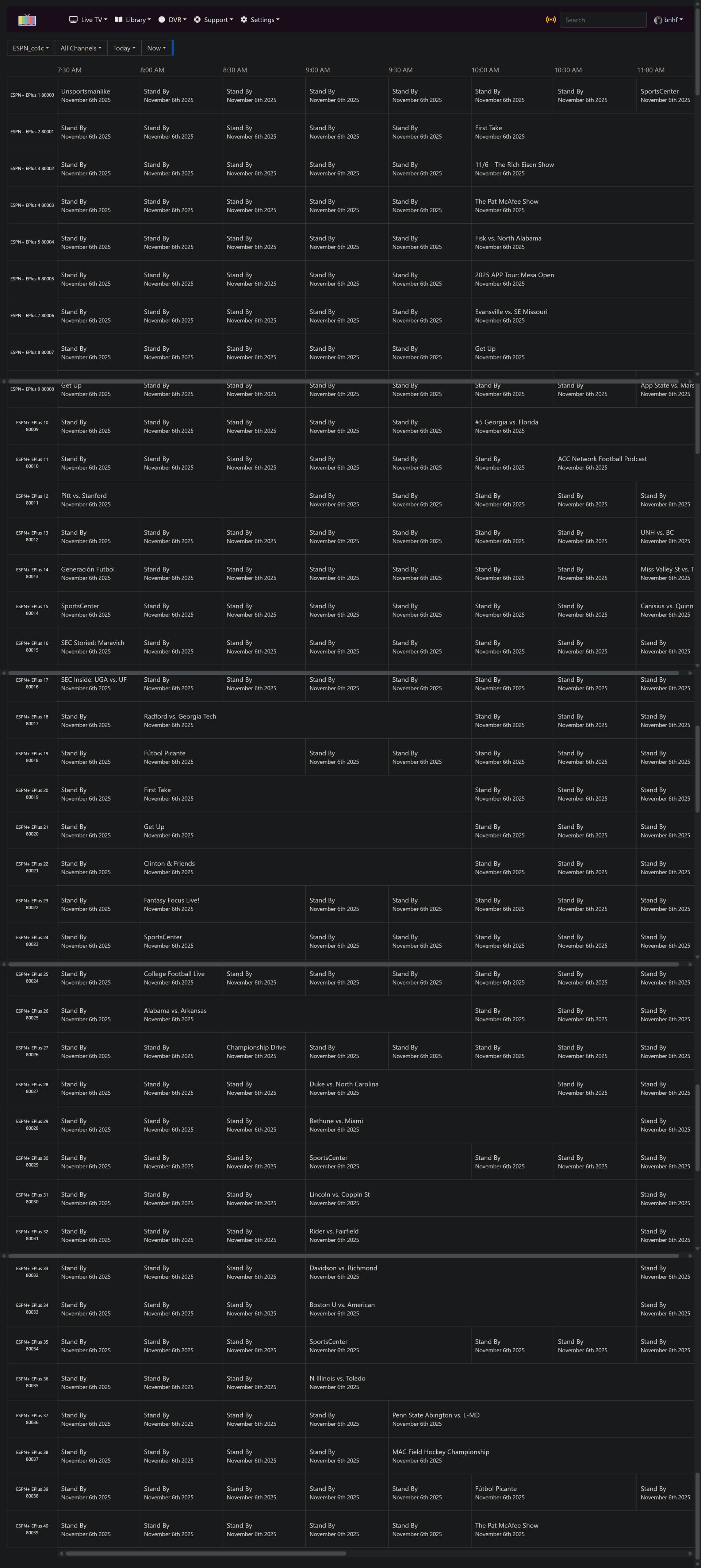

I did get my custom version up and working. Although I think I am going to go back and start with the ESPN4CC base as it looks like it schedules into time-slots similar to how EPlusTV did it vs. a channel per stream event. Not sure what will be better in the long run, but just experimenting.
thats my fav feature of ESPN4CC that it creates a mini-guide... it was a nightmare to get programmed and i still dont love the implementation. I'd love to re-create that with Stream Links, but snafu is CDVR won't allow redirects on a Streamlink. It's basically a send it and forget it.
only workaround i could fathom is to force cdvr to reload the m3u every minute with the "scheduled" program but that sounds clunky.
wish list would be is if CDVR supported some sort of Streamlink url inside the XML/EPG (as opposed to using the M3U url), or a way to auto-refresh a dynamic m3u whenever channel is called.
pretty niche request so not sure devs would be open to that.

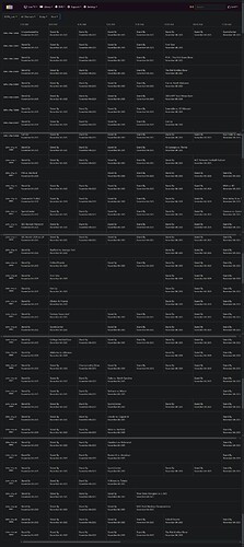

I think if I could limit the events to only the things I want, there might be an advantage to the "flat" guide, particularly if specific teams/leagues could go on a specific channels.
The nice thing about the "tiled" guide is that it can pack many events into a reasonable channel space. At certain times of year, there are hundreds of different sports of events on at a given time, and perhaps thousands a day.
I am going to play around with both, and if you are interested in my thoughts on either or both, happy to report back. Either way, I really appreciate your work. Being able to get these to my HDMI tuners will produce a much more reliable stream and better picture. Ultimately I think this will be an upgrade over EPlusTV. BTW, it might be worth opening a thread specifically for ESPN4CC, as the CC4C thread is pretty full as is.
My biggest issue with just using the ESPN app is finding the particular event I want to watch. Despite telling it my favorite teams/leagues, etc. I still have to scroll through 300 random sporting events.
Channels is great, but it also does not have a favorite team/show concept. It does, have a DVR. So if I create a "season pass" I (mostly) get what I want.

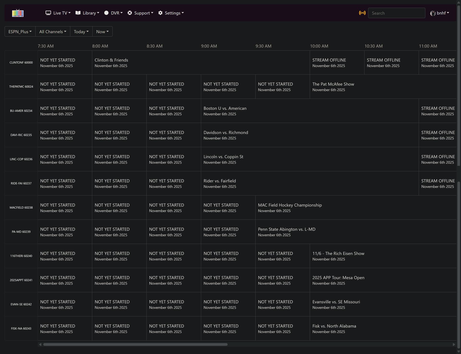

@bnhf
Got everything set up. I've got guide data but when I select anything, it opens the DTV Stream app.
I've attached the Portainer log, the Compose, and my environment variables.
Firestick 4K
ESPN app loaded and signed in.
No hurry as I'm here to help where I can!!
Let me know if you need anything else.
