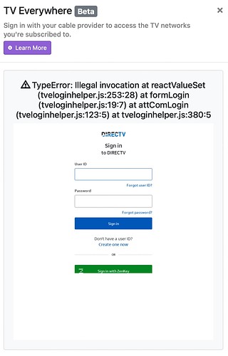

Hello! I'm brand new here and trying to get up and running. When I try to add DirecTV as a source, I input my credentials but I get the following error:
TypeError: Illegal invocation at reactValueSet (tveloginhelper.js:253:28) at formLogin (tveloginhelper.js:19:7) at attComLogin (tveloginhelper.js:123:5) at tveloginhelper.js:380:5
I've searched a whole bunch trying to get this solved, but I can't find any similar issues. Apologies if I'm being redundant, it's unintentional.

Thanks for the diagnostics. New build coming with fix.

There were several fixes for DirecTV authentication in the pre-releases since the last stable release. You can either wait for the next stable release, or you can update to a current pre-release.

worked!
Build 2022.03.19.0040 worked for me. Thx.
