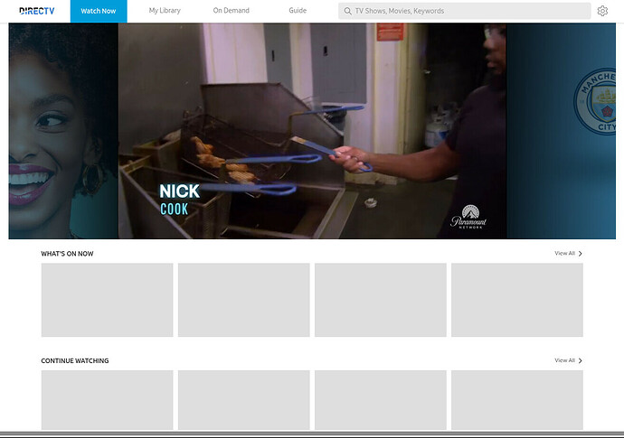

I tried this feature on Sunday night and was able to get the noVNC window to log in to my DirecTV account but got no playlist.
I used the "directv-tuner" image.
I've been following the thread and it seems that the right image doesn't have the dash in the name.
I'll have to retry it.
correct, the dash version was pushed by mistake. use the no dash version.

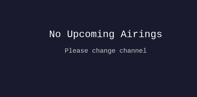

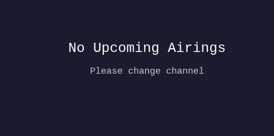

Added a new feature if there are no upcoming airings like nfl RedZone you will see this
instead of the guide

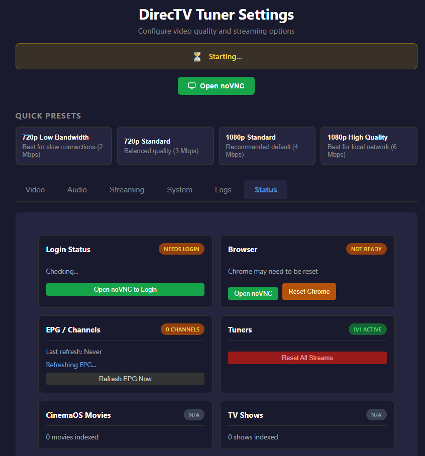

I have a playlist with 348 channels but unable to play.
I'm on a Windows 11 PC with the basic docker image because I can't benefit from NVIDIA or Intel GPUs.
A little bit closer but still not working.
:worried:
There's not much in the log.
Ideas for troubleshooting?
there a gui section ip:7070 if you go there there is a log section share please

noVNC window:
yes i see one sec i saw an issue on my end fixing

Just updated on the latest channel. channel icons are broken also have av sync issues.
Looking better with 267 channels, including my local channels, but still unable to play in Channels DVR (I haven't tried anything else). I can see in the noVNC window that it is able to switch channels when requested by the DVR but no stream is getting to the DVR.
You want the full log again?
Are you able to play in vlc? Are you using the urls on the ip:7070 web page? are you using latest or nvidia? thanks
see if reboot fixes it
