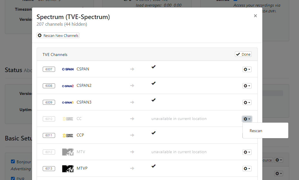

I just assumed initially I didn't get those channels. Then I was looking at the Edit section and noticed they were listed "403 failed too many streams", so I Googled that and found this thread. Once I realized what was happening based on jay343's comment I just went back every hour or so and rescanned 2 channels at a time until they were all added to the Channels guide.
The only recommendation I'd have for the Channels team would be to add an option to the menu to just force the channel into the guide even if the scan fails. That way I wouldn't have had to keep going back and scanning two at a time channels I know would have worked without this limitation.

I'm talking about putting this deep in the edit menu like here...
To get to that you have to click the menu next to the source, click Manage Line Up, click Edit, and then open that little menu next to the channel. That's pretty deep to be accidentally clicked. And they could always add a little popup warning like "You still may not be able to record/watch this channel if authorization fails"
I'm sure most of us using this product are at least a little tech savvy and wouldn't start messing with menus like that unless we really needed to.

Understandable. That's why I suggested adding an option to the menu to force a channel to add even if it fails the test.
The idea I had was slightly different... any channels that got this specific error would be automatically retried, one pers hour or something like that. So even if they fail during the initial scan they would gradually appear over time.
That kind of mechanism could be beneficial for other failure modes too, to try again every so often automatically.
