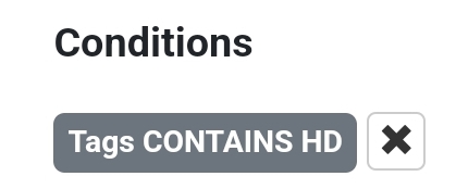

Another possible variant of an advanced pass: would this work?
No?
Edit: I'll answer my own question: no.
I just realized that the tag is part of the EPG and not related to the actual video stream.
I did try that one also!!!
