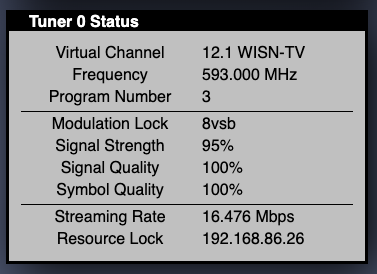

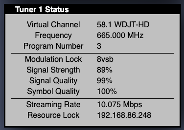

bad ass thank you! thatll be a great resource to have. i'm pulling 100% or high 90's for everything so far so good so far! thanks again for everyones help!
If you're getting 100% for signal strength beware. 100% is merely a number used to show its strength, but it does not show if it is stronger than 100%. This is significant, because HDHR tuners can be quite sensitive to overly strong signals.
i did read something about that. before this i was using a hauppage usb tuner and used their signal meter and i showed very close to 100 w/ that but not quite so hoping i'm ok. If i AM getting a too strong of a signal i thought i saw a recommendation of something I could add to help? (cant remember the name )
the only device i have right now is a channel master distribution amp which helped quite a bit w/ my signal when i first got this setup a year ago
I've got broadcast towers only a couple miles from my house and it is not an issue. If I put an amplifier on the signal though, it would be too loud... I wouldn't be able to tune any channels... which is why I don't use amplifiers. But they can be good if you are farther away. The metric to look at is symbol quality. This should be 100% for a perfect picture. Signal Strength and Signal Quality can help to achieve perfect symbol quality, but having these other metrics maxed is not always necessary. Sometimes, especially if there is some kind of interference in the dead-on direction toward the towers, you can turn the antenna slightly (which will lower the signal quality). If you can keep it consistently around 80% though and the signal is still strong, you will still be able to get perfect symbol quality (perfect picture) in all weather... + you may have eliminated the interference.
