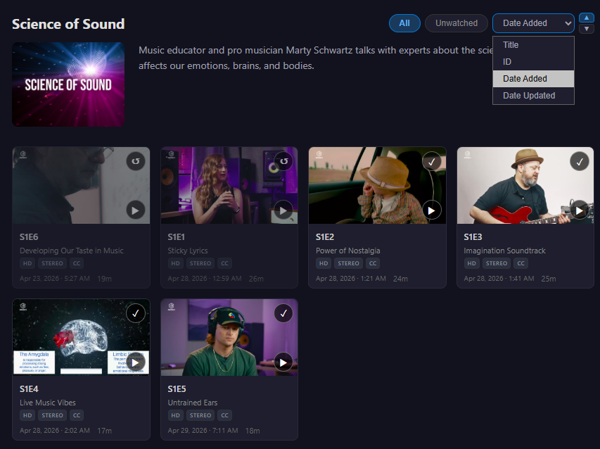

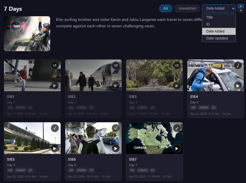

I may be missing something obvious here, but how do you sort a TV Show's episodes by Season, then Episode? So this example would sort as S1E1, S1E2, S1E3, S1E4, S1E5, S1E6
None of the available sort options work.
This one just happens to work because it was recorded in episode order.

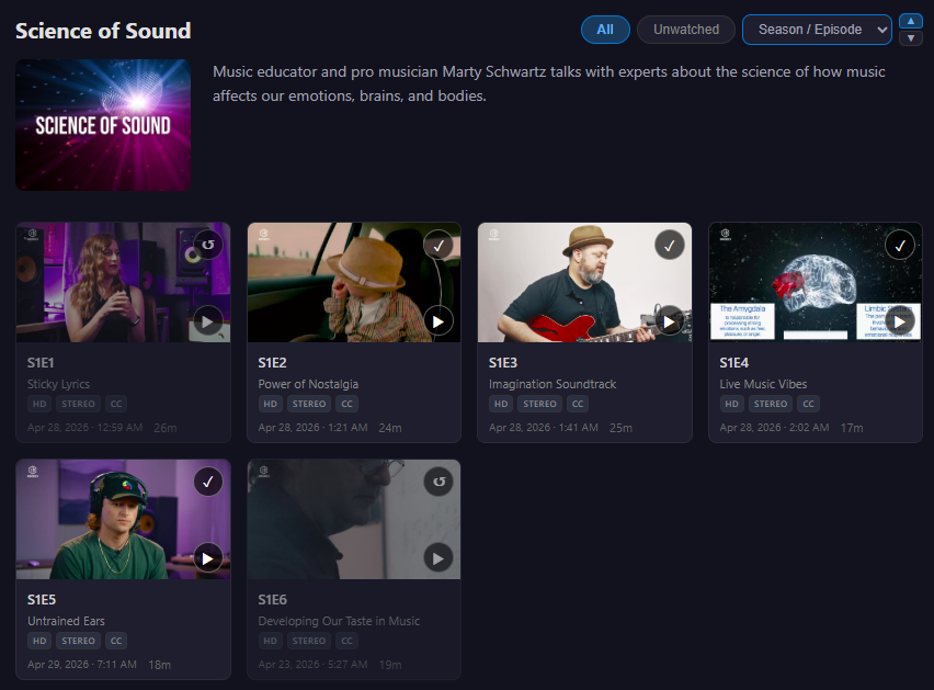

I added season and episode as well as first aired. Also added release date to movies. V1.7 - it may take a few minutes to finish building...

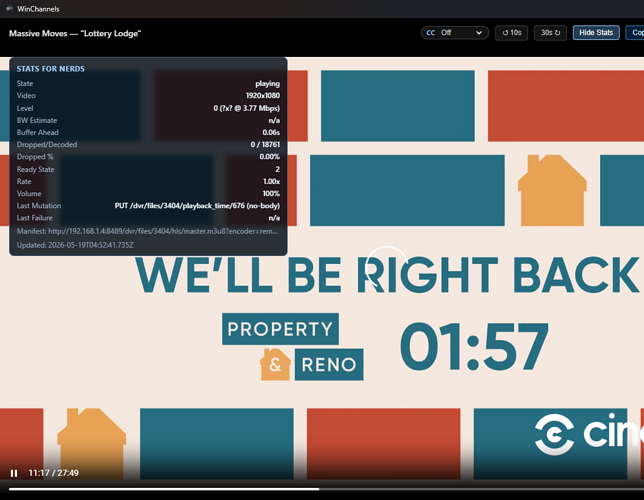

Any changes from v1.7.0 to v1.9.0 that would affect playing back recordings?
I was playing back a recording using v1.9.0 and it kept pausing and I'd get the buffering circle.
Had to skip ahead to get it playing again.
So I did what I use to do when seeing that same behavior in the CDVR web UI player.
Deleted the video index and then it played fine.
Was going to reinstall v1.7.0 to see if it worked on the recording until I saw you just released v1.9.1.
V1.91 addresses a problem I found with cc4c. When it tuned a cc4c channel live, then stopped the playback, it would not stop the stream, so it continues to use resources on the server.
I've only seen the buffering circle on cc4c channels, and usually a few seconds after starting the stream. I found that restarting the stream recovered it. Let me know if you see a pattern, or if you see anything in WinChannels error log, or in the Channels log that corresponds to it.

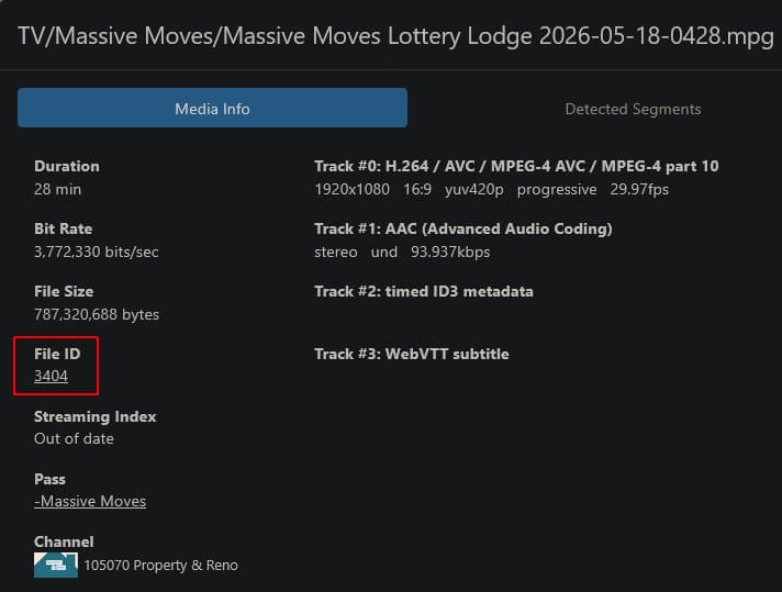

Like I said, if I delete the CDVR video index it plays fine.
How do you delete the index?
Delete the Metadata/FILE_ID# folder
Metadata/3404 in this case

http://server-ip:port/dvr/files/3404/stream.mpg
That may require a different player. Before I look into that, do you know if the "Fix Video Timestamps" command does the job?
It doesn't happen with every recording and I'm not going to run that on my recordings.
I can search here for the few times I did that and it ruined my recordings, like Make backup of recording before rewriting video timestamps
If CDVR doesn't have the video index (because I deleted it) it plays fine in the web UI player and yours.
I'll just delete the video index folders. Probably will setup a cron job for that.

So on the recordings that stall with the buffering, spinning circle.
Either deleting the video index, or remuxing w/ffmpeg and regenerating the video index fixes it.
I don't see issues looking at them with my video editor and no errors from the ffmpeg remux.
I found if I just remux the recording and don't touch the video index that it plays with artifacts, smearing, tearing, macro-blocking, etc. Either deleting the video index or regenerating it cures that. There's something wrong with CDVR and its video index. I wish they would offer a way to play a recording without using the video index.
Until then, I'll setup a cron job to delete the video indexes after they're created.
