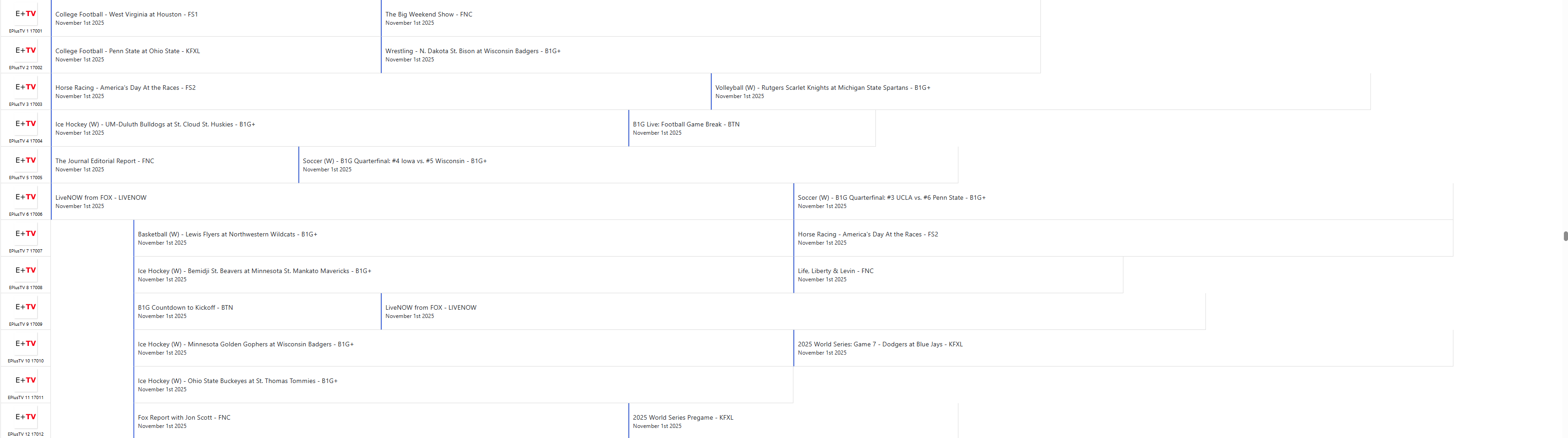

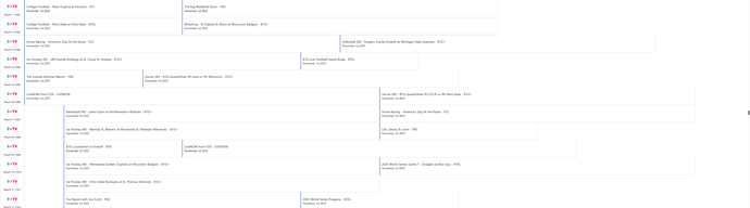

I noticed that the channel moves around in the Guide. FNC starts out on Eplus5 then after 1/2 hour moves to Eplus12 then moves to Eplus8???
Also, the guide on my Clients do not match the guide on the server. I tried to refresh the source on the client, clear cache, force close and reopen and it doesn't update.
Sounds like you don’t have the “Dedicated Linear Channels” option enabled in EPlusTV. So events are getting assigned to random virtual channels rather than their dedicated linear channel.
You were right.
