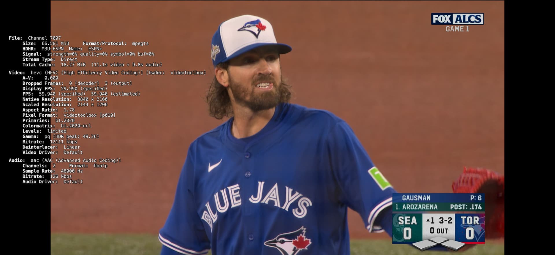

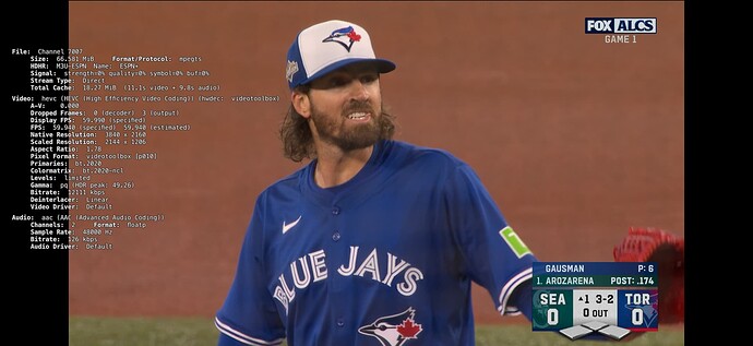

Available here (Seattle market) in 4K via E+
I’m able to watch the game in 4k through ETV CHANNEL 17523. Montgomery, Alabama market WCOV. It looks great!
Edit: it seems my M2 Mac mini is struggling to play the 4K channels. My Internet is 300 up/300 down. The channel would keep hanging up and then would boot me out.
Working here. 4K.
