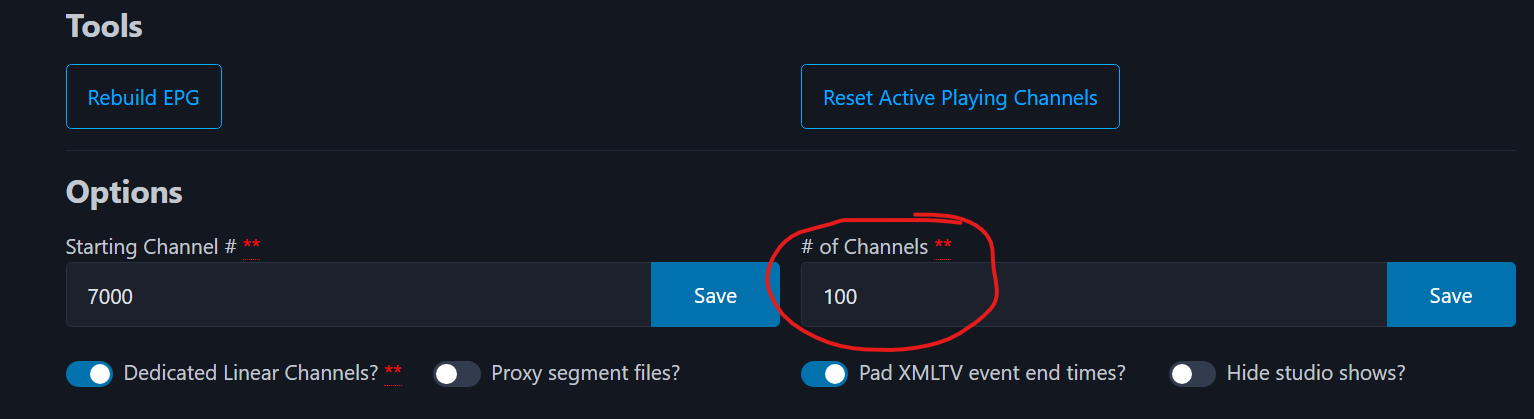

I want to use the service, but it generates hundreds of channels. I know I can limit to "linear only", but that prohibits me from using my MLB subscripton. How can I get this working w/o having hundreds of useless channels in the guide?
Lower the # of Channels setting to the max you think you'd need for your purpose, then rebuild EPG and reload xml in Channels.
Also, refer to the initial post in this thread about Channel Collections. With the Automatic Channels settings, you can limit the channel number to those actually broadcasting events.
