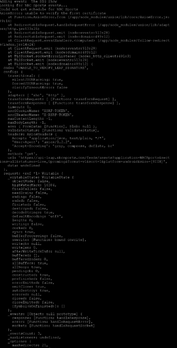

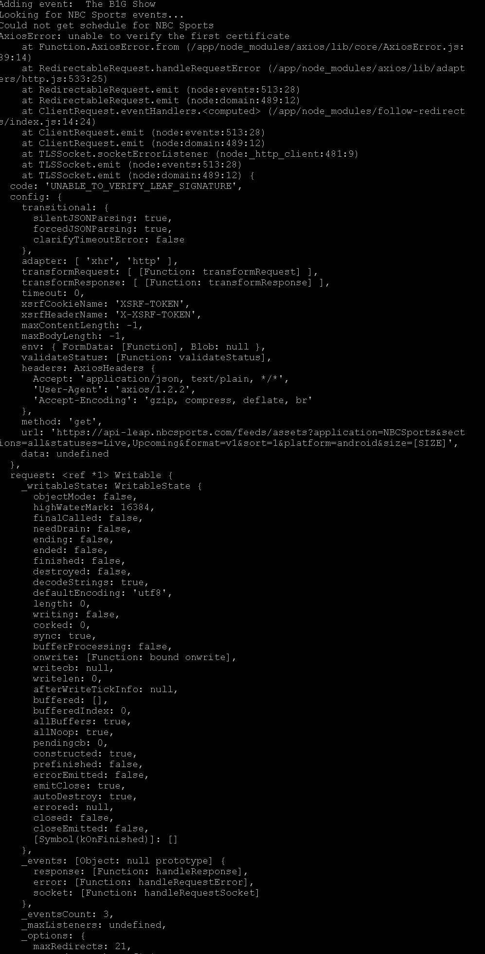

Seems like it can't grab NBC Sports events anymore
if i remember right a lot of the gulf streams being brought in by nbcsports can't be plalyed however i did go into nbcsports and found the same result.
I'm unsure when it isn't pull and when it is a restriction.
