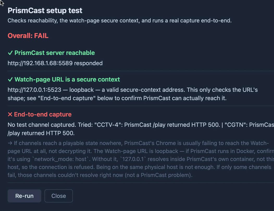

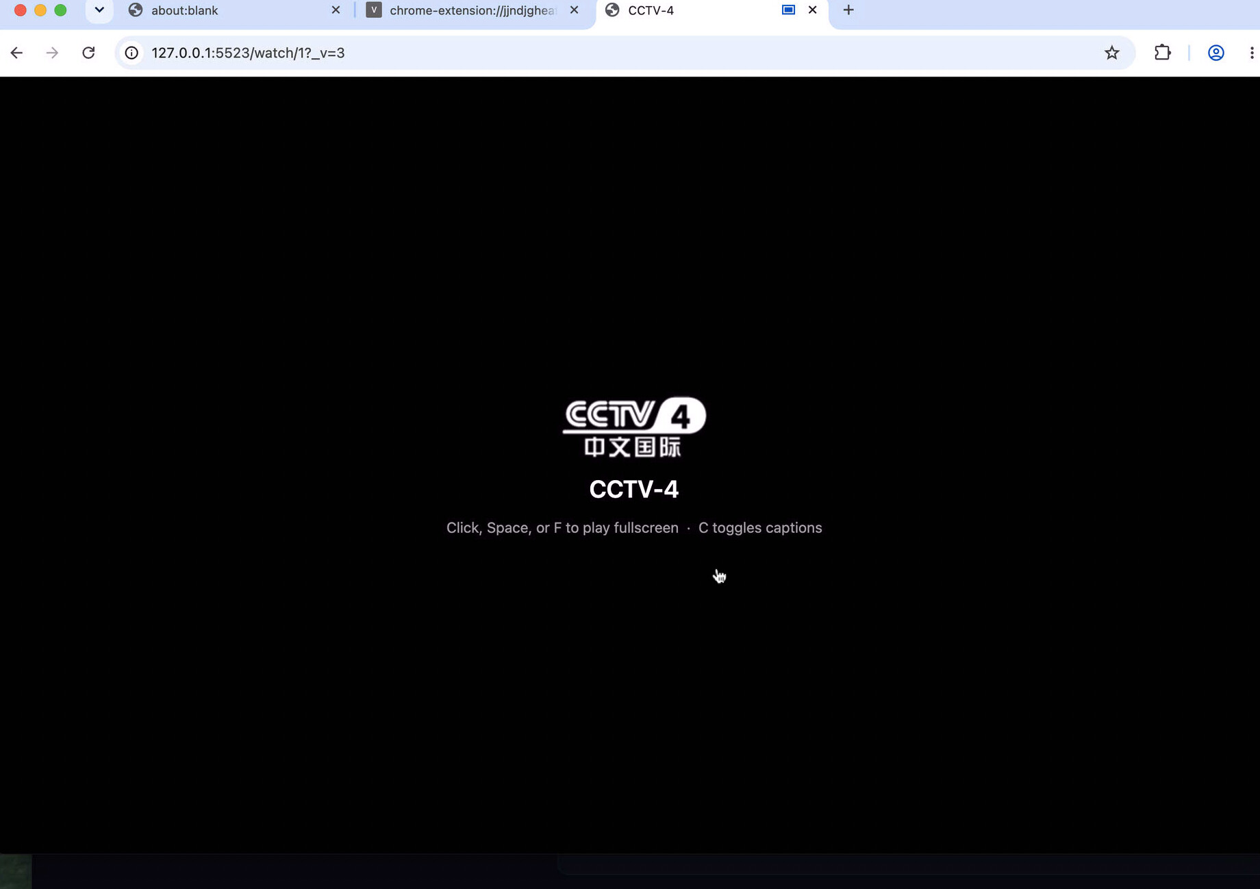

If it helps at all, this is the result when the prismcast test fails:
And this is what is visible when chrome opens:

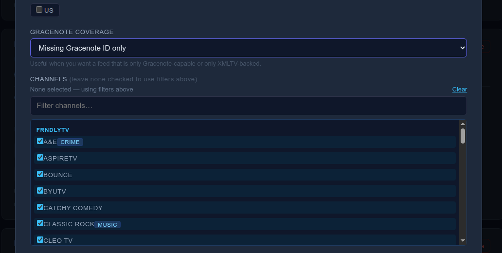

Are those channels setup with Gracenote coverage, or using my EPG?
The channels only list when choosing "Missing Gracenote" so guessing your EPG.

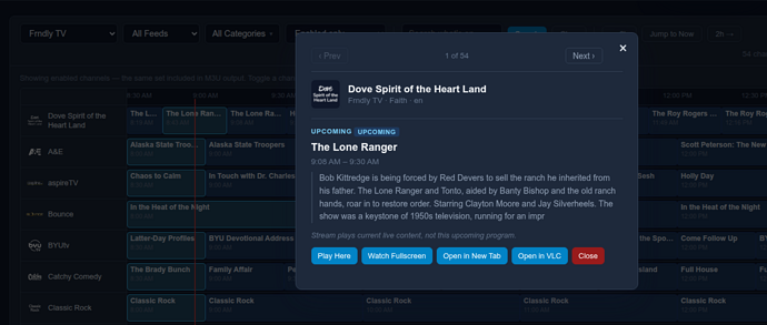

Here's a screen shot:
Not seeing program image here.
And here's what I said before, they are only showing up as "missing Gracenote ID".
thats odd - I show Gracenote coverage on all those channels. Wonder if you have a setting wrong?

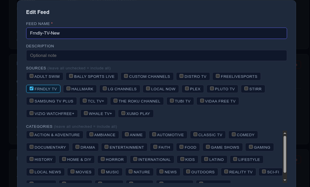

Humor me - disable your Frindly Source. Wait a few minutes for it to purge the channels from theDB. Then, re-setup Friendly feed. Do not use the gracenote coverage filter. Then, send me a screenshot of the feed setup.
also, go into CDVR and remove the feeds for Friendly you added originally. we'll recreate it with the new one from above.

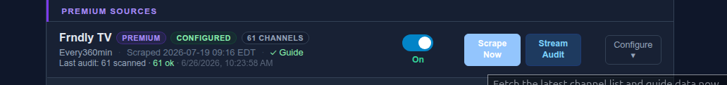

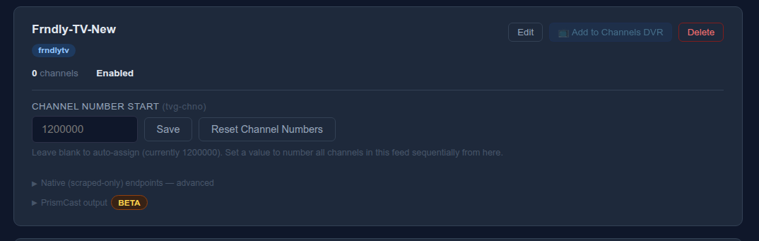

Disabled, waited 5 minutes, enabled:
Deleted the Feed, recreated (says 0 channels):

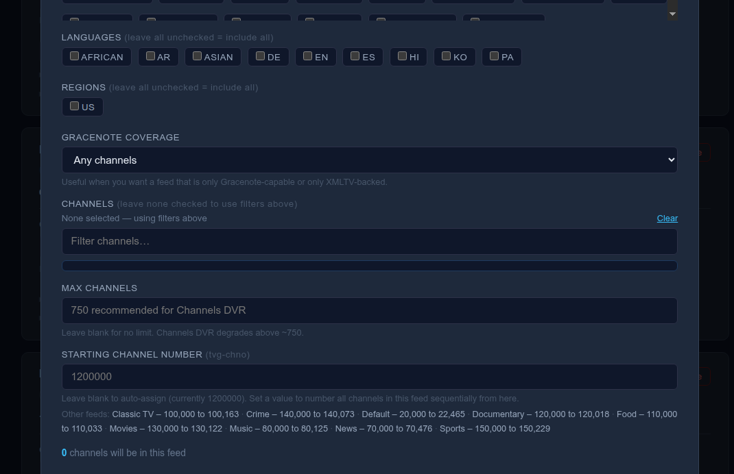

Just so you see as much as possible, here's the feed setup:

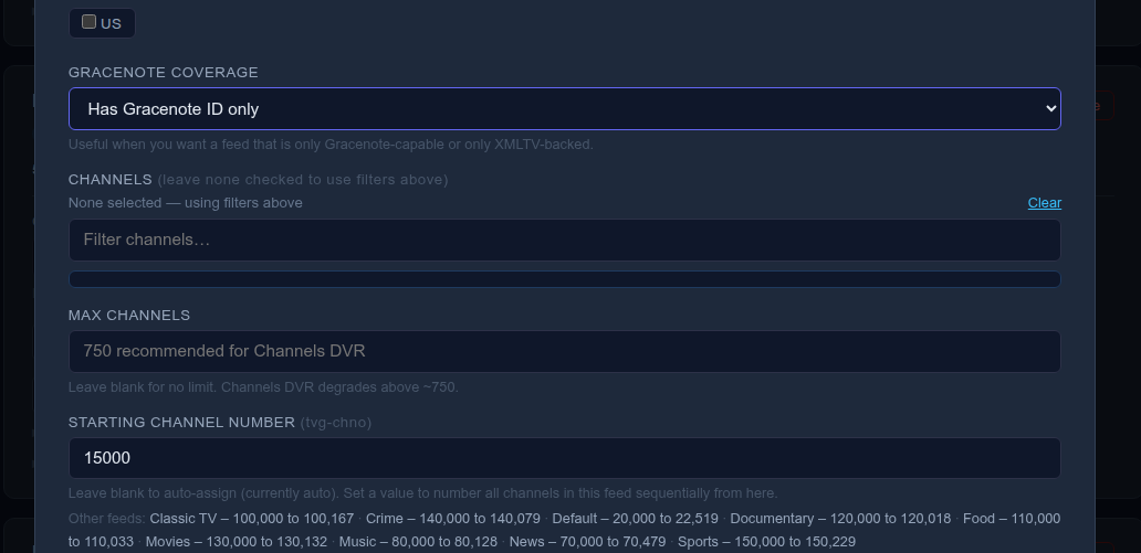

This time there are no channels for has Gracenote or missing Gracenote.
and you forced a scrape? makes no sense why the feed would be blank.
Yes, I did. This doesn't make any sense, I agree. It's actually worse than before as I'm getting no channels in a feed.
FYI to anyone following in the future- we worked on this in a PM converation. RockandRoller had some special characters in his Frndly password that the scraper didn't like. All fixed now.
Thought I'd give it another whack this morning. Loaded PrismCast natively on my 2018 Mac mini i5. I finally got it to pass the FastChannels test setup after configuring the Watch-page URL for PrismCast's browser (optional) with http://127.0.0.1:5523. A station will start playing for about a minute, then stops, then starts again and it will repeatedly do that until I finally get the "The connection to the tuner was lost. Press play to try again" message. If I press play, it repeats the same behavior. CPU on the mini is <20% during playback. I can see Chrome pop up multiple times in playback and I see it in the PrismCast logs:
